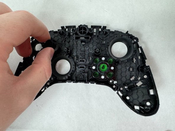

  6. Razer Wolverine V2 Chroma RZ06-0401 ABXY Buttons Replacement, ABXY Buttons: crwdns2935265:06crwdnd2935265:01crwdnd2935265:03crwdne2935265:0 Razer Wolverine V2 Chroma RZ06-0401 ABXY Buttons Replacement, ABXY Buttons: crwdns2935265:06crwdnd2935265:02crwdnd2935265:03crwdne2935265:0 Razer Wolverine V2 Chroma RZ06-0401 ABXY Buttons Replacement, ABXY Buttons: crwdns2935265:06crwdnd2935265:03crwdnd2935265:03crwdne2935265:0
    • Look at the inside of the inner front plate and where the ABXY buttons are. Pop off the back of the piece that pushes the buttons.

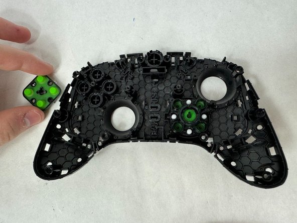

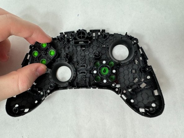

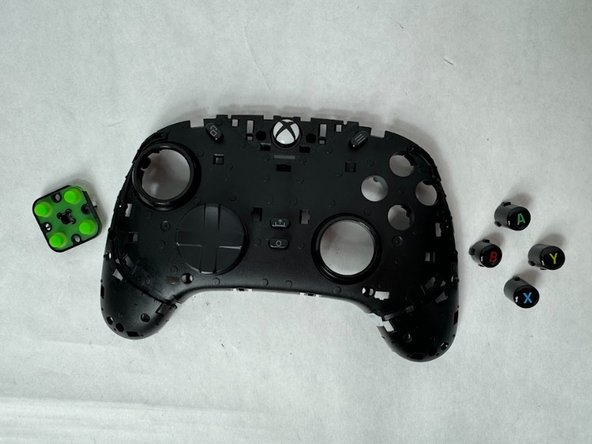

  7. Razer Wolverine V2 Chroma RZ06-0401 ABXY Buttons Replacement: crwdns2935265:07crwdnd2935265:01crwdnd2935265:03crwdne2935265:0 Razer Wolverine V2 Chroma RZ06-0401 ABXY Buttons Replacement: crwdns2935265:07crwdnd2935265:02crwdnd2935265:03crwdne2935265:0 Razer Wolverine V2 Chroma RZ06-0401 ABXY Buttons Replacement: crwdns2935265:07crwdnd2935265:03crwdnd2935265:03crwdne2935265:0
    • The buttons should come out easily once the previous piece is removed.
    • By tilting the controller they should fall out, or you can push them out yourself if that did not happen.
    • You are now able to clean the buttons and the area around it (if necessary), and slide the new buttons back into place.
