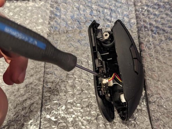

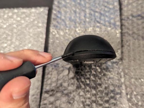

    • With the flathead screwdriver, carefully open the sides and back, unclipping the bottom shell from the mouse.
  4. Razer Viper Ultimate Upper Shell Replacement: crwdns2935265:04crwdnd2935265:01crwdnd2935265:02crwdne2935265:0 Razer Viper Ultimate Upper Shell Replacement: crwdns2935265:04crwdnd2935265:02crwdnd2935265:02crwdne2935265:0

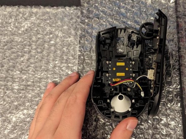

    • Disconnect the three-pin connector cable under the Printed Circuit Board (PCB). Take off the cable with yellow, red, and black wires to reach the four 2.5 mm screws holding the battery and switches.
  5. Razer Viper Ultimate Upper Shell Replacement: crwdns2935265:05crwdnd2935265:01crwdnd2935265:02crwdne2935265:0 Razer Viper Ultimate Upper Shell Replacement: crwdns2935265:05crwdnd2935265:02crwdnd2935265:02crwdne2935265:0
    • Use a small Phillips-head screwdriver to remove the four 2.5 mm screws that secure the battery unit.

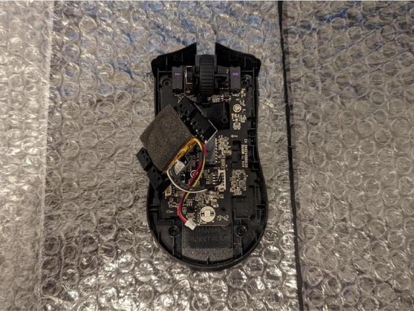

    • Move the PCB with the battery from the old shell to the new one. Align the 4 plastic guide pegs with the holes in the PCB.

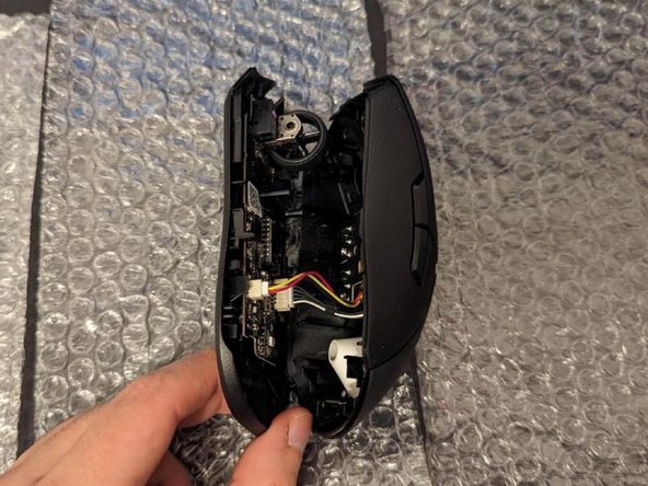

  8. Razer Viper Ultimate Upper Shell Replacement: crwdns2935265:08crwdnd2935265:01crwdnd2935265:02crwdne2935265:0 Razer Viper Ultimate Upper Shell Replacement: crwdns2935265:08crwdnd2935265:02crwdnd2935265:02crwdne2935265:0
    • Reconnect the three-pin connector cables from step 4.
