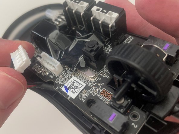

  5. Razer Viper Mini Trigger Switches Replacement, Disconnect the Ribbon Connector: crwdns2935265:05crwdnd2935265:01crwdnd2935265:02crwdne2935265:0 Razer Viper Mini Trigger Switches Replacement, Disconnect the Ribbon Connector: crwdns2935265:05crwdnd2935265:02crwdnd2935265:02crwdne2935265:0
    • Disconnect the ribbon connector between the motherboard and the USB cable by squeezing the connector and pulling up.
    • Pulling too hard could damage the wire connections.
    • Pulling by the ribbon instead of the connector can dislocate the wires.
  6. Razer Viper Mini Trigger Switches Replacement, Unscrew Motherboard from Case: crwdns2935265:06crwdnd2935265:01crwdnd2935265:01crwdne2935265:0
    • Use a Phillips #0 screwdriver to remove 2 5.5 and 3 2.5 mm screws.

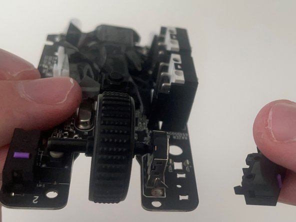

  7. Razer Viper Mini Trigger Switches Replacement, Remove Motherboard: crwdns2935265:07crwdnd2935265:01crwdnd2935265:01crwdne2935265:0
    • Remove the motherboard by grasping the sides and gently pulling upward.

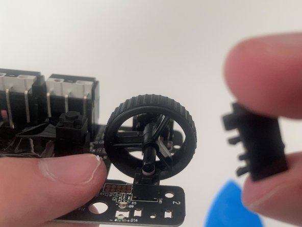

  8. Razer Viper Mini Trigger Switches Replacement, Remove Left Switch: crwdns2935265:08crwdnd2935265:01crwdnd2935265:02crwdne2935265:0 Razer Viper Mini Trigger Switches Replacement, Remove Left Switch: crwdns2935265:08crwdnd2935265:02crwdnd2935265:02crwdne2935265:0
    • Press the connectors upwards to remove the left switch from the PCB.
  9. Razer Viper Mini Trigger Switches Replacement, Remove Right Switch: crwdns2935265:09crwdnd2935265:01crwdnd2935265:02crwdne2935265:0 Razer Viper Mini Trigger Switches Replacement, Remove Right Switch: crwdns2935265:09crwdnd2935265:02crwdnd2935265:02crwdne2935265:0
    • Press the connectors upwards to remove the Right switch from the PCB.
