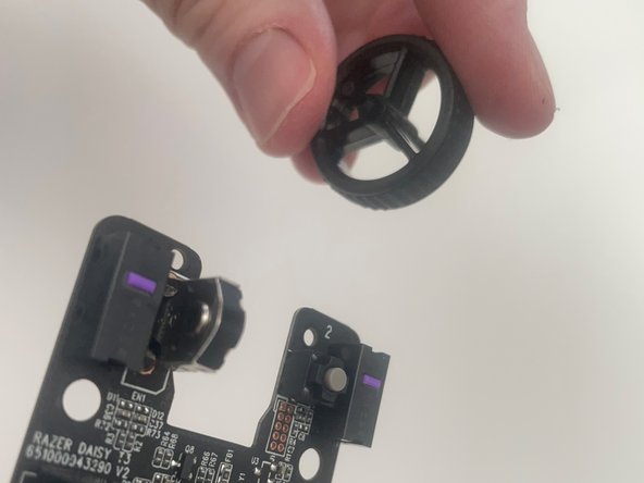

  7. Razer Viper Mini Scroll Wheel Replacement, Remove Motherboard: crwdns2935265:07crwdnd2935265:01crwdnd2935265:01crwdne2935265:0
    • Remove the motherboard by grasping the sides and gently pulling upward.
  8. Razer Viper Mini Scroll Wheel Replacement, Remove Scroll Wheel from case: crwdns2935265:08crwdnd2935265:01crwdnd2935265:02crwdne2935265:0 Razer Viper Mini Scroll Wheel Replacement, Remove Scroll Wheel from case: crwdns2935265:08crwdnd2935265:02crwdnd2935265:02crwdne2935265:0
    • Remove the scroll wheel from the socket by pulling to the right.
    • Pulling too hard could damage the scroll wheel connector.
