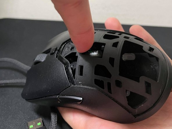

  4. Razer Viper Mini Cable Replacement: crwdns2935265:04crwdnd2935265:01crwdnd2935265:02crwdne2935265:0 Razer Viper Mini Cable Replacement: crwdns2935265:04crwdnd2935265:02crwdnd2935265:02crwdne2935265:0
    • Use the plastic spudger once again to remove the shell of the mouse.
    • It is exactly like the previous step as you have to dig the plastic spudger gently into the bottom of the mouse and move it inwards to slowly release the shell.
    • You have now successfully removed the top shell of the mouse!

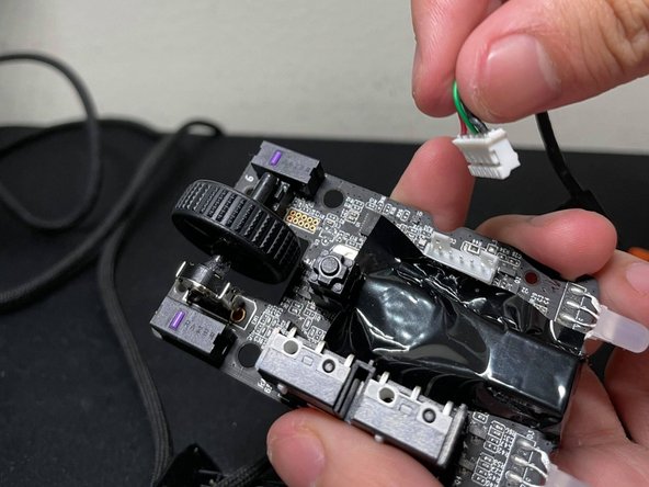

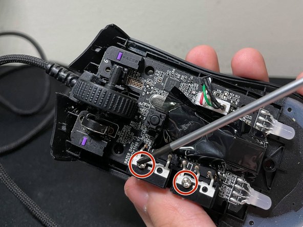

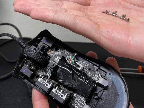

  5. Razer Viper Mini Cable Replacement: crwdns2935265:05crwdnd2935265:01crwdnd2935265:03crwdne2935265:0 Razer Viper Mini Cable Replacement: crwdns2935265:05crwdnd2935265:02crwdnd2935265:03crwdne2935265:0 Razer Viper Mini Cable Replacement: crwdns2935265:05crwdnd2935265:03crwdnd2935265:03crwdne2935265:0
    • Use your Philips #0 screwdriver to remove five 2.5 mm screws from the board.
    • Unscrewing the top two screws will make it easier for you to get to the others after.

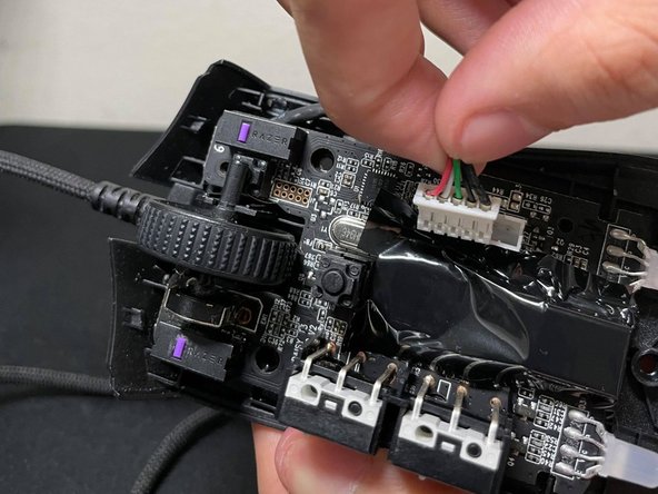

  6. Razer Viper Mini Cable Replacement: crwdns2935265:06crwdnd2935265:01crwdnd2935265:03crwdne2935265:0 Razer Viper Mini Cable Replacement: crwdns2935265:06crwdnd2935265:02crwdnd2935265:03crwdne2935265:0 Razer Viper Mini Cable Replacement: crwdns2935265:06crwdnd2935265:03crwdnd2935265:03crwdne2935265:0
    • Use your small chain nose pilers to remove the molex power connection cable from the PCB.
    • Wiggle the port slightly while grasping the ends it in order to release it safely.
    • Do not use a large amount of force as you can easily damage your mouse's PCB.

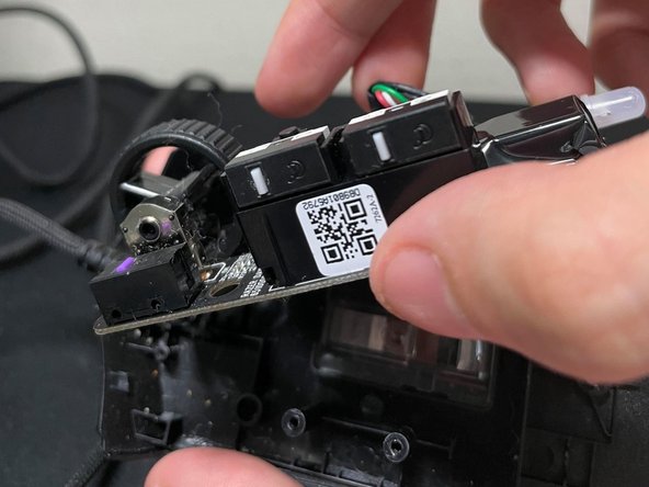

    • Remove the PCB from the bottom plate.
  7. Razer Viper Mini Cable Replacement: crwdns2935265:07crwdnd2935265:01crwdnd2935265:03crwdne2935265:0 Razer Viper Mini Cable Replacement: crwdns2935265:07crwdnd2935265:02crwdnd2935265:03crwdne2935265:0 Razer Viper Mini Cable Replacement: crwdns2935265:07crwdnd2935265:03crwdnd2935265:03crwdne2935265:0
    • Remove the old cable.
    • Make sure your new mouse cable has a 5-pin molex connector that is compatible with the Razer Viper's PCB.
    • Route the cable through the previous route that the original cable was in, remembering to press down with your Phillips #0 screwdriver so the PCB can fit nicely on top.
    • Lastly, plug the molex power connector of the new cable back into the PCB of the Razer Viper Mini and make sure it is tightly fitted.
