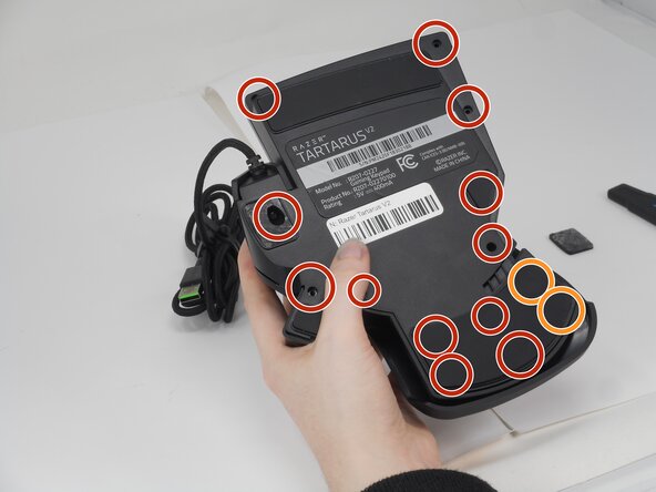

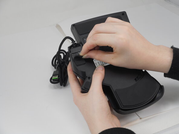

    • Turn the keypad upside down.
  2. Razer Tartarus V2 Keys 1-19 Replacement: crwdns2935265:02crwdnd2935265:01crwdnd2935265:03crwdne2935265:0 Razer Tartarus V2 Keys 1-19 Replacement: crwdns2935265:02crwdnd2935265:02crwdnd2935265:03crwdne2935265:0 Razer Tartarus V2 Keys 1-19 Replacement: crwdns2935265:02crwdnd2935265:03crwdnd2935265:03crwdne2935265:0

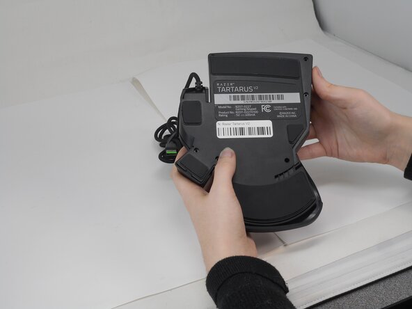

    • Gently peel off the rubber feet with a Jimmy.
    • Set the rubber grip pads aside so you can reapply them later.
    • Use a Phillips #0 screwdriver to remove the following screws:
    • Twelve 6.4 mm-long screws
    • Two 3.7 mm-long screws
  3. Razer Tartarus V2 Keys 1-19 Replacement: crwdns2935265:03crwdnd2935265:01crwdnd2935265:03crwdne2935265:0 Razer Tartarus V2 Keys 1-19 Replacement: crwdns2935265:03crwdnd2935265:02crwdnd2935265:03crwdne2935265:0 Razer Tartarus V2 Keys 1-19 Replacement: crwdns2935265:03crwdnd2935265:03crwdnd2935265:03crwdne2935265:0

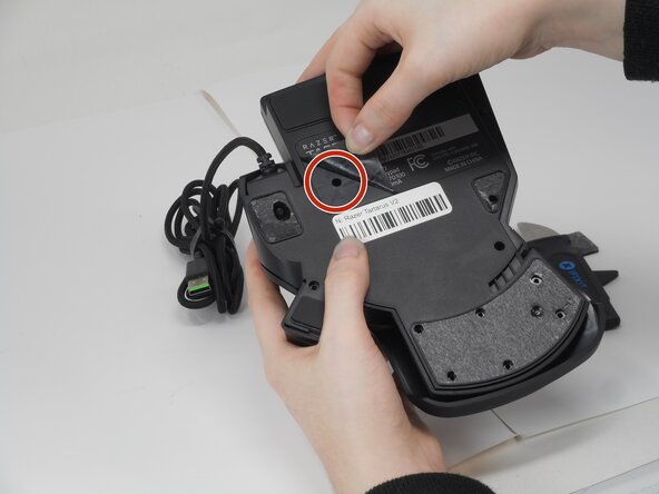

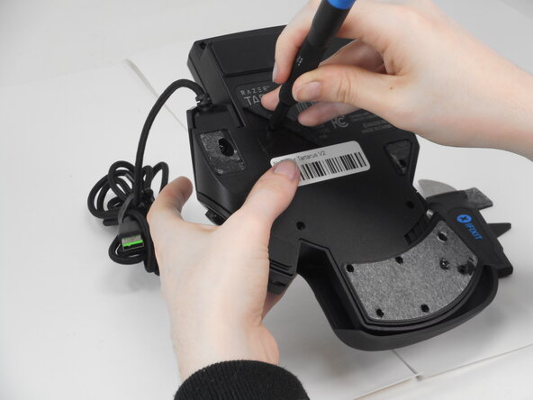

    • Peel up the bottom left corner of the largest sticker.
    • Remove the 6.4 mm-long Phillips #0 screw.

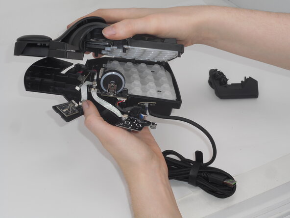

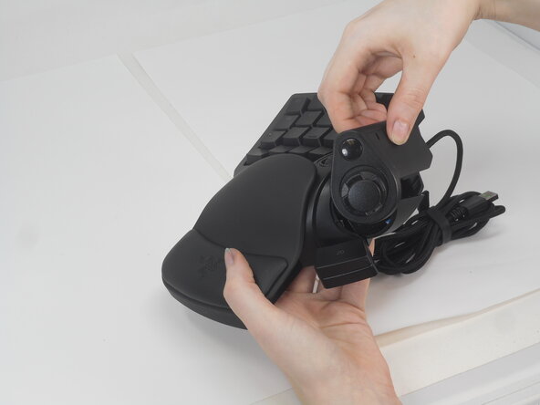

  4. Razer Tartarus V2 Keys 1-19 Replacement: crwdns2935265:04crwdnd2935265:01crwdnd2935265:03crwdne2935265:0 Razer Tartarus V2 Keys 1-19 Replacement: crwdns2935265:04crwdnd2935265:02crwdnd2935265:03crwdne2935265:0 Razer Tartarus V2 Keys 1-19 Replacement: crwdns2935265:04crwdnd2935265:03crwdnd2935265:03crwdne2935265:0

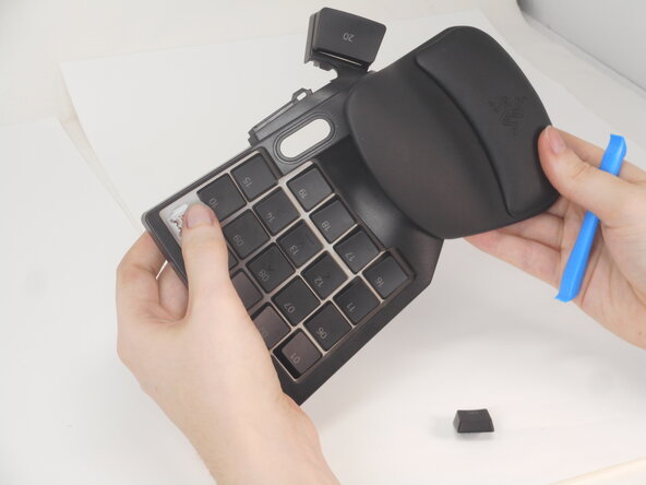

    • Carefully lift the joystick module up and out.
    • Separate the top and bottom casing of the keypad.
    • Use an Opening tool to pry the case open along the edges if necessary.
  5. Razer Tartarus V2 Keys 1-19 Replacement, Keys 1-19: crwdns2935265:05crwdnd2935265:01crwdnd2935265:01crwdne2935265:0
    • To take off the keys, place the flat end of the opening tool under the edge of the key. Gently pry the key cap off of the board.

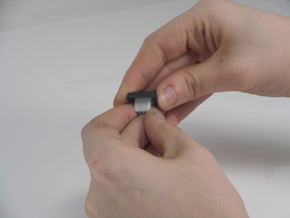

  6. Razer Tartarus V2 Keys 1-19 Replacement: crwdns2935265:06crwdnd2935265:01crwdnd2935265:03crwdne2935265:0 Razer Tartarus V2 Keys 1-19 Replacement: crwdns2935265:06crwdnd2935265:02crwdnd2935265:03crwdne2935265:0 Razer Tartarus V2 Keys 1-19 Replacement: crwdns2935265:06crwdnd2935265:03crwdnd2935265:03crwdne2935265:0

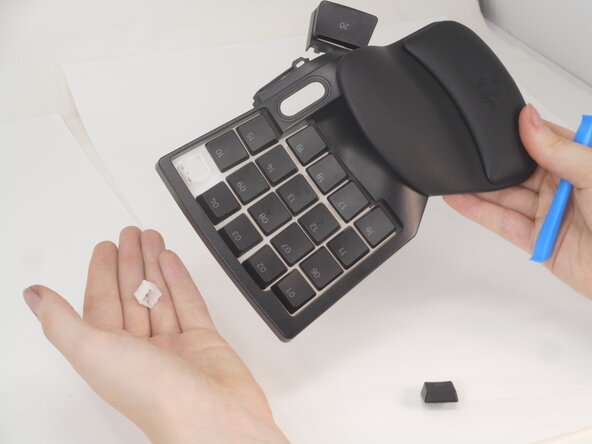

    • The key stem, a small white block-like object, may be left behind. If this happens the keyboard must be opened. Once opened separate the top casing from the bottom casing and gently press the stem towards where the inside of the keyboard would be. They should pop out in this direction.
  7. Razer Tartarus V2 Keys 1-19 Replacement: crwdns2935265:07crwdnd2935265:01crwdnd2935265:02crwdne2935265:0 Razer Tartarus V2 Keys 1-19 Replacement: crwdns2935265:07crwdnd2935265:02crwdnd2935265:02crwdne2935265:0
    • You can then place them back on the keycap by placing the end that has a small number on it back into the connector on the keycap. There is a small bump on the bottom edge of the stem, this should be facing direction of the top edge of the keycap.
To put keys back in, the stem should be attached to the key cap. The key can then be pushed back into its designated spot of the keyboard. With the Razer Tartarus V2, the keys are labeled 1-19 so they go into the board in numerical order.
