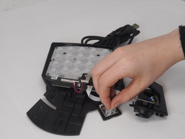

    • Turn the keypad upside down.
  2. Razer Tartarus V2 Keycap Stabilizers Replacement: crwdns2935265:02crwdnd2935265:01crwdnd2935265:03crwdne2935265:0 Razer Tartarus V2 Keycap Stabilizers Replacement: crwdns2935265:02crwdnd2935265:02crwdnd2935265:03crwdne2935265:0 Razer Tartarus V2 Keycap Stabilizers Replacement: crwdns2935265:02crwdnd2935265:03crwdnd2935265:03crwdne2935265:0
    • Gently peel off the rubber feet with a Jimmy.
    • Set the rubber grip pads aside so you can reapply them later.
    • Use a Phillips #0 screwdriver to remove the following screws:
    • Twelve 6.4 mm-long screws
    • Two 3.7 mm-long screws
  3. Razer Tartarus V2 Keycap Stabilizers Replacement: crwdns2935265:03crwdnd2935265:01crwdnd2935265:03crwdne2935265:0 Razer Tartarus V2 Keycap Stabilizers Replacement: crwdns2935265:03crwdnd2935265:02crwdnd2935265:03crwdne2935265:0 Razer Tartarus V2 Keycap Stabilizers Replacement: crwdns2935265:03crwdnd2935265:03crwdnd2935265:03crwdne2935265:0
    • Peel up the bottom left corner of the largest sticker.
    • Remove the 6.4 mm-long Phillips #0 screw.
  4. Razer Tartarus V2 Keycap Stabilizers Replacement: crwdns2935265:04crwdnd2935265:01crwdnd2935265:03crwdne2935265:0 Razer Tartarus V2 Keycap Stabilizers Replacement: crwdns2935265:04crwdnd2935265:02crwdnd2935265:03crwdne2935265:0 Razer Tartarus V2 Keycap Stabilizers Replacement: crwdns2935265:04crwdnd2935265:03crwdnd2935265:03crwdne2935265:0
    • Carefully lift the joystick module up and out.
    • Separate the top and bottom casing of the keypad.
    • Use an Opening tool to pry the case open along the edges if necessary.
  5. Razer Tartarus V2 Keycap Stabilizers Replacement, Keycap Stabilizers: crwdns2935265:05crwdnd2935265:01crwdnd2935265:02crwdne2935265:0 Razer Tartarus V2 Keycap Stabilizers Replacement, Keycap Stabilizers: crwdns2935265:05crwdnd2935265:02crwdnd2935265:02crwdne2935265:0
    • Locate the two rubber stabilizers:
    • One large stabilizer is positioned under keys 1–19.
    • One small stabilizer is under key 20.
    • Carefully pull each stabilizer up by hand from its respective board (motherboard or daughterboard)
    • Avoid applying excessive force or using sharp tools to prevent scratching or damaging the boards beneath the stabilizers.
