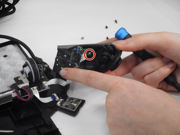

  3. Razer Tartarus V2 D-Pad Replacement: crwdns2935265:03crwdnd2935265:01crwdnd2935265:03crwdne2935265:0 Razer Tartarus V2 D-Pad Replacement: crwdns2935265:03crwdnd2935265:02crwdnd2935265:03crwdne2935265:0 Razer Tartarus V2 D-Pad Replacement: crwdns2935265:03crwdnd2935265:03crwdnd2935265:03crwdne2935265:0
    • Peel up the bottom left corner of the largest sticker.
    • Remove the 6.4 mm-long Phillips #0 screw.

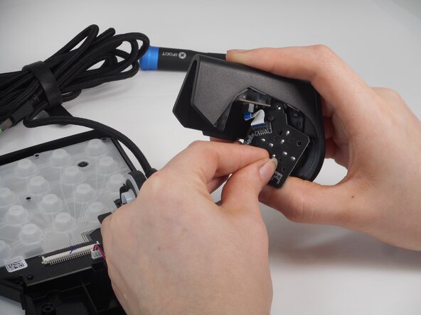

  5. Razer Tartarus V2 D-Pad Replacement, D-Pad: crwdns2935265:05crwdnd2935265:01crwdnd2935265:03crwdne2935265:0 Razer Tartarus V2 D-Pad Replacement, D-Pad: crwdns2935265:05crwdnd2935265:02crwdnd2935265:03crwdne2935265:0 Razer Tartarus V2 D-Pad Replacement, D-Pad: crwdns2935265:05crwdnd2935265:03crwdnd2935265:03crwdne2935265:0
    • Remove the two 6.4 mm-long screws that secure the D-Pad PCB inside the casing with a Phillips #0 screwdriver.
    • There are two pairs of prongs that secure the D-Pad PCB to the housing. Use your fingernails to squeeze each set of prongs inward while gently prying the PCB away from the housing to disengage them.
    • Repeat the previous bullet for the remaining set of prongs.
    • Carefully pull the PCB away from the housing.
    • Take care not to strain the connected ribbon cables.

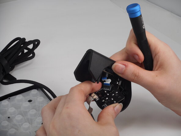

  6. Razer Tartarus V2 D-Pad Replacement: crwdns2935265:06crwdnd2935265:01crwdnd2935265:03crwdne2935265:0 Razer Tartarus V2 D-Pad Replacement: crwdns2935265:06crwdnd2935265:02crwdnd2935265:03crwdne2935265:0 Razer Tartarus V2 D-Pad Replacement: crwdns2935265:06crwdnd2935265:03crwdnd2935265:03crwdne2935265:0
    • Remove the two 4.9 mm silver screws that secures the smaller PCB with a Phillips #0 screwdriver.
    • One of these two screws is behind a connector ribbon and the D-Pad PCB must be gently pulled to the side to access it.
    • Gently pull the smaller PCB away from the white plastic underneath it.

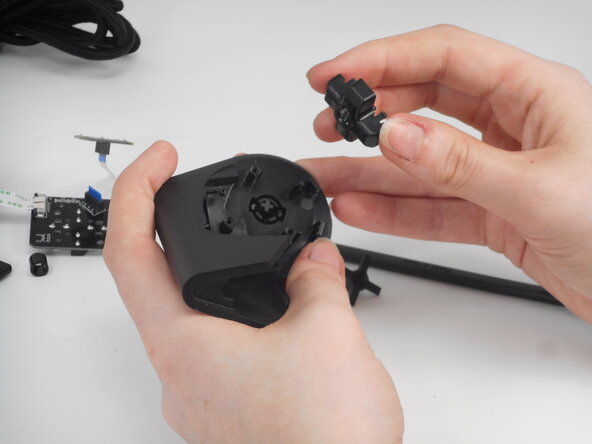

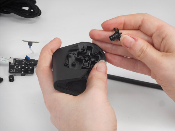

  7. Razer Tartarus V2 D-Pad Replacement: crwdns2935265:07crwdnd2935265:01crwdnd2935265:01crwdne2935265:0
    • Remove the white plastic bracket from the casing.
    • A plastic ring will fall out after both PCBs are are removed. It belongs under one of the screw in points for the larger daughter board.

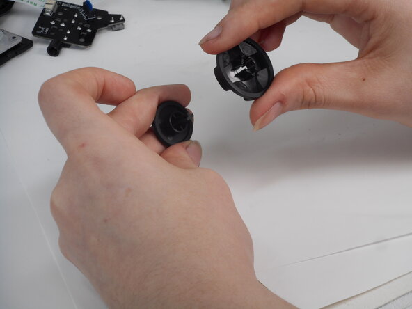

  8. Razer Tartarus V2 D-Pad Replacement: crwdns2935265:08crwdnd2935265:01crwdnd2935265:03crwdne2935265:0 Razer Tartarus V2 D-Pad Replacement: crwdns2935265:08crwdnd2935265:02crwdnd2935265:03crwdne2935265:0 Razer Tartarus V2 D-Pad Replacement: crwdns2935265:08crwdnd2935265:03crwdnd2935265:03crwdne2935265:0
    • Use the hooked end of a halberd spudger to get under the edge of the smaller cross.
    • Pry all four arms of the smaller cross.
    • This step may require more force than removing the daughterboards.
    • Remove both cross structures from the casing.

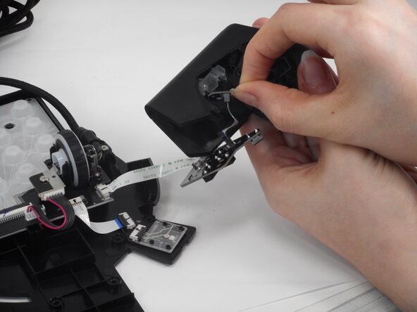

  9. Razer Tartarus V2 D-Pad Replacement: crwdns2935265:09crwdnd2935265:01crwdnd2935265:02crwdne2935265:0 Razer Tartarus V2 D-Pad Replacement: crwdns2935265:09crwdnd2935265:02crwdnd2935265:02crwdne2935265:0
    • Pull the D-Pad out from its seated position. It will come off together with the D-Pad casing.
