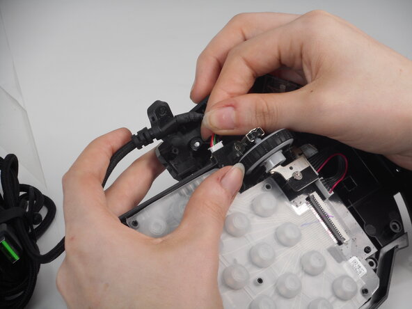

  5. Razer Tartarus V2 Cord Replacement, Cord: crwdns2935265:05crwdnd2935265:01crwdnd2935265:01crwdne2935265:0
    • Remove the 5.9 mm-long Phillips #0 screw that secures the cord.
  6. Razer Tartarus V2 Cord Replacement: crwdns2935265:06crwdnd2935265:01crwdnd2935265:02crwdne2935265:0 Razer Tartarus V2 Cord Replacement: crwdns2935265:06crwdnd2935265:02crwdnd2935265:02crwdne2935265:0
    • Use the pointed edge of a spudger to gently "walk" the white connector directly out of its socket.
    • Avoid pulling on the cables.
    • To reattach the cord, carefully align the connector end with the prongs inside the connection slot. Misalignment or using too much force can bend the prongs, potentially making the connection unusable. Once aligned, gently press the connector into the slot until it is fully seated.
