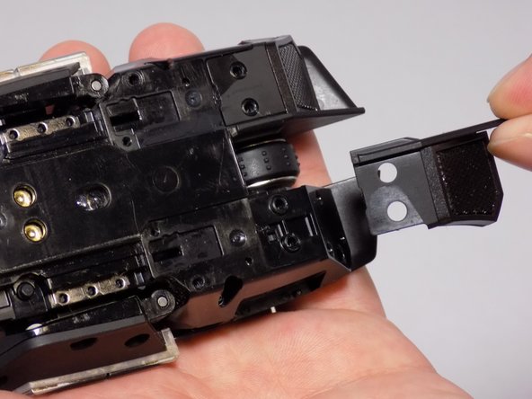

    • Remove all of the stickers on the back of the mouse. After doing so, you should see six screws on the back of the mouse.
    • Use the Phillips #0 Screwdriver to remove all six of these 4mm screws.
    • Use the Phillips #00 Screwdriver to remove these two, 3mm screws.
    • Slide the side panels off of the mouse.
    • Use your tweezers to take the lock switches off of the mouse.

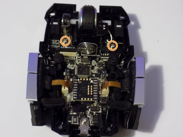

    • Locate the 4mm screw indicated in the first picture, use a Phillips #00 Screwdriver to remove it.
    • Locate the two 4mm screws in the second picture, and remove those two with a Phillips #0 Screwdriver.
    • Now, you may remove the board that holds the scroll wheel and its components. Simply slide the wheel out and replace it.
    • Take note of the orientation in the final picture so that you can place the wheel back correctly into its mechanism.

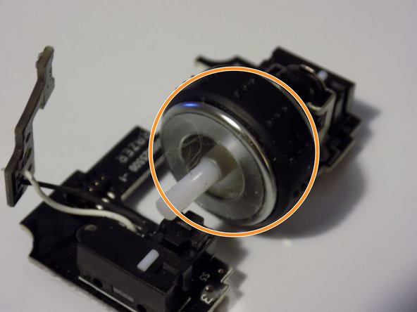

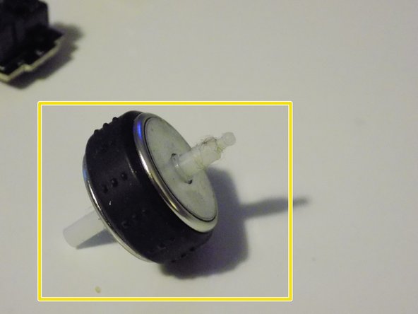

    • Carefully remove the circuit board that is inside the scroll wheel.
    • Pull the scroll wheel off the board.
    • Place the scroll wheel in a safe location.

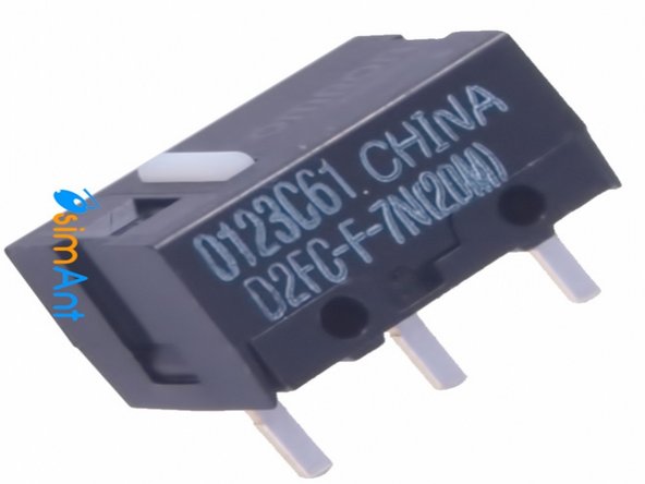

    • When you get to this point look at your micro switch to check that this is exactly the same.

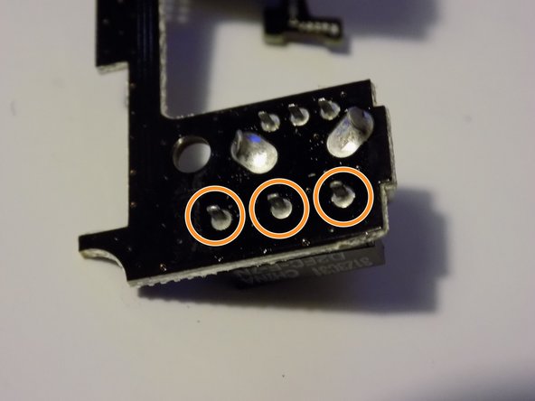

    • If this is your first time soldering I would recommend watching this ifixit guide. How To Solder and Desolder Connections
    • Now de solder the 3 pass through post continue pulling the micro switch away from the circuit board
    • Replace and solder the micro switch to the circuit board.
