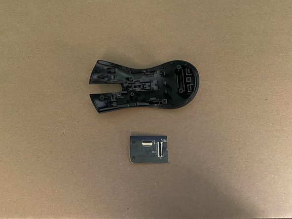

  1. Razer Naga Epic Top Panel Disassembly, Identify attachment points: crwdns2935265:01crwdnd2935265:01crwdnd2935265:02crwdne2935265:0 Razer Naga Epic Top Panel Disassembly, Identify attachment points: crwdns2935265:01crwdnd2935265:02crwdnd2935265:02crwdne2935265:0
    • The PCB is held to the top panel by...
    • 2 x 6mm Phillips #0 screws towards the front
    • 2 grooves on the top panel holding it in towards the rear
  2. Razer Naga Epic Top Panel Disassembly, Unscrew the PCB: crwdns2935265:02crwdnd2935265:01crwdnd2935265:01crwdne2935265:0
    • Unscrew the 2 screws holding the PCB into the top panel.

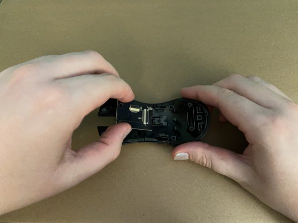

  3. Razer Naga Epic Top Panel Disassembly, Slide PCB away from the top panel: crwdns2935265:03crwdnd2935265:01crwdnd2935265:03crwdne2935265:0 Razer Naga Epic Top Panel Disassembly, Slide PCB away from the top panel: crwdns2935265:03crwdnd2935265:02crwdnd2935265:03crwdne2935265:0 Razer Naga Epic Top Panel Disassembly, Slide PCB away from the top panel: crwdns2935265:03crwdnd2935265:03crwdnd2935265:03crwdne2935265:0
    • Carefully slide the PCB horizontally away from the grooves on the rear end of the top panel.
