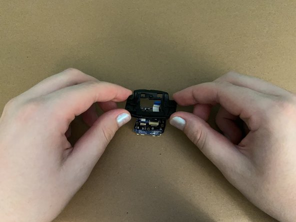

    • The buttons and their PCB are held into the side panel by a retaining bracket.
    • Unscrew the 4 x 6mm Phillips #0 screws securing the retaining bracket in place.

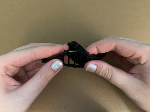

    • The retaining bracket is gently clipped in to the side panel.
    • Gently go round between the retaining bracket and the side panel with a spudger until it comes loose.
    • You can now separate the retaining bracket.

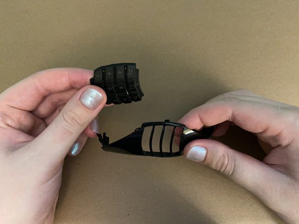

  3. Razer Naga Epic Numpad Disassembly, Push button cover out from side case: crwdns2935265:03crwdnd2935265:01crwdnd2935265:03crwdne2935265:0 Razer Naga Epic Numpad Disassembly, Push button cover out from side case: crwdns2935265:03crwdnd2935265:02crwdnd2935265:03crwdne2935265:0 Razer Naga Epic Numpad Disassembly, Push button cover out from side case: crwdns2935265:03crwdnd2935265:03crwdnd2935265:03crwdne2935265:0
    • Gently push the rubber button covers out from the side panel. They are not clipped or held in place by anything.

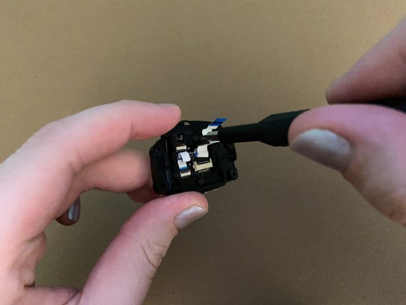

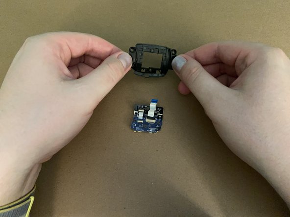

  4. Razer Naga Epic Numpad Disassembly, Unscrew retaining bracket from PCB bundle: crwdns2935265:04crwdnd2935265:01crwdnd2935265:02crwdne2935265:0 Razer Naga Epic Numpad Disassembly, Unscrew retaining bracket from PCB bundle: crwdns2935265:04crwdnd2935265:02crwdnd2935265:02crwdne2935265:0
    • The button contacts, corresponding PCB, and transparent panel are held together into the retaining bracket by 4 x 6mm Phillips #000 screws.
    • Unscrew the 4 screws.

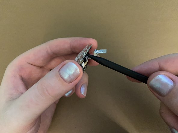

  5. Razer Naga Epic Numpad Disassembly, Remove retaining bracket from PCB bundle: crwdns2935265:05crwdnd2935265:01crwdnd2935265:03crwdne2935265:0 Razer Naga Epic Numpad Disassembly, Remove retaining bracket from PCB bundle: crwdns2935265:05crwdnd2935265:02crwdnd2935265:03crwdne2935265:0 Razer Naga Epic Numpad Disassembly, Remove retaining bracket from PCB bundle: crwdns2935265:05crwdnd2935265:03crwdnd2935265:03crwdne2935265:0
    • Lift the inner retaining bracket away from the PCB bundle.
    • When reassembling, make sure the ribbon cable is threaded through the opening in the retaining bracket.

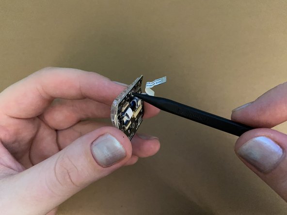

  6. Razer Naga Epic Numpad Disassembly, Separate transparent panel: crwdns2935265:06crwdnd2935265:01crwdnd2935265:03crwdne2935265:0 Razer Naga Epic Numpad Disassembly, Separate transparent panel: crwdns2935265:06crwdnd2935265:02crwdnd2935265:03crwdne2935265:0 Razer Naga Epic Numpad Disassembly, Separate transparent panel: crwdns2935265:06crwdnd2935265:03crwdnd2935265:03crwdne2935265:0
    • The transparent panel is threaded through the button contacts and PCB via 4 screw holes.
    • Using the pointed end of a spudger, gently push the screw holes to push the transparent panel away from the PCB.
    • Exercise caution and be delicate as there are many flexible components here.
