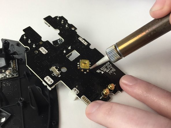

  12. Razer Naga Epic Chroma Tracking Sensor Replacement: crwdns2935265:012crwdnd2935265:01crwdnd2935265:01crwdne2935265:0
    • Around the yellow sensor, located in the middle of the back of the circuit board, locate the eleven "leads" (soldered connections) surrounding the yellow sensor.
  13. Razer Naga Epic Chroma Tracking Sensor Replacement: crwdns2935265:013crwdnd2935265:01crwdnd2935265:02crwdne2935265:0 Razer Naga Epic Chroma Tracking Sensor Replacement: crwdns2935265:013crwdnd2935265:02crwdnd2935265:02crwdne2935265:0
    • Re-solder all eleven leads to the connection points of the sensor.
    • This should fix the problem with the mouse sensor tracking issues.
    • For soldering tips, refer to this guide.
To reassemble your device, follow these instructions in reverse order from steps 1-5.

Worked on my regular chroma. Just a cold solder joint.
