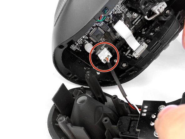

    • Gently remove the top plastic shell from the mouse.
    • Be careful when lifting the shell up to avoid damage to the cable connected to the board and shell.
    • The top shell is separate from the sides of the mouse.
    • Unplug the cable coming from the top shell that connects to the board.
