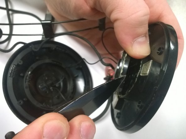

    • To get to the speaker you need to remove the six 5mm screws from the inner housing plate.
    • After doing this you can pull the housing apart exposing the speaker.

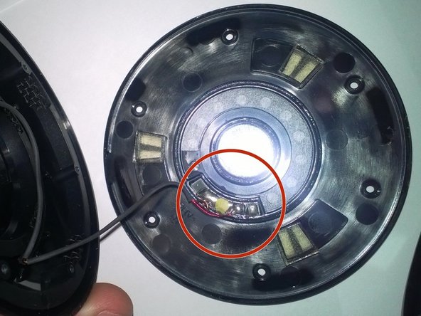

  3. Razer Megalodon – Virtual 7.1 Surround Sound USB Gaming Headset Speaker Replacement: crwdns2935265:03crwdnd2935265:01crwdnd2935265:03crwdne2935265:0 Razer Megalodon – Virtual 7.1 Surround Sound USB Gaming Headset Speaker Replacement: crwdns2935265:03crwdnd2935265:02crwdnd2935265:03crwdne2935265:0 Razer Megalodon – Virtual 7.1 Surround Sound USB Gaming Headset Speaker Replacement: crwdns2935265:03crwdnd2935265:03crwdnd2935265:03crwdne2935265:0
    • Use a knife to cut the glue around the speaker that is holding it to the assembly.
    • Once the glue is cut, pry the speaker out. Cut the wires at the base of the speaker and then replace them.
    • A solder gun will be needed to solder the wires onto the new speaker.
