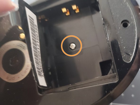

    • Remove one screw from the bottom of the mouse beneath the mouse foot using a Phillips #00 screwdriver.
    • Remove one screw from the bottom of the mouse in the battery compartment using a Phillips #00 screwdriver.

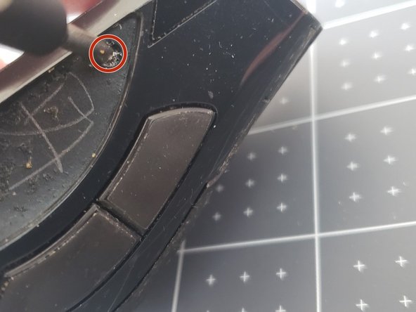

    • Remove the screws from under the thumb/sidepads using a Phillips #00 screwdriver.

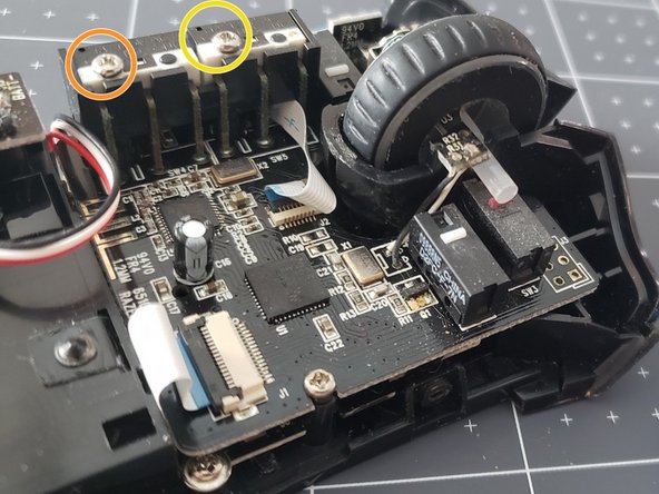

  6. Razer Mamba RC30-001201 Left/Right Micro Switch Replacement: crwdns2935265:06crwdnd2935265:01crwdnd2935265:02crwdne2935265:0 Razer Mamba RC30-001201 Left/Right Micro Switch Replacement: crwdns2935265:06crwdnd2935265:02crwdnd2935265:02crwdne2935265:0
    • Remove the screw holding the right side of the board down using a Phillips #00 screwdriver.
    • Remove the screw holding side micro switch using a Phillips #00 screwdriver.
    • Remove the screw holding the front side micro switch using a Phillips #00 screwdriver.

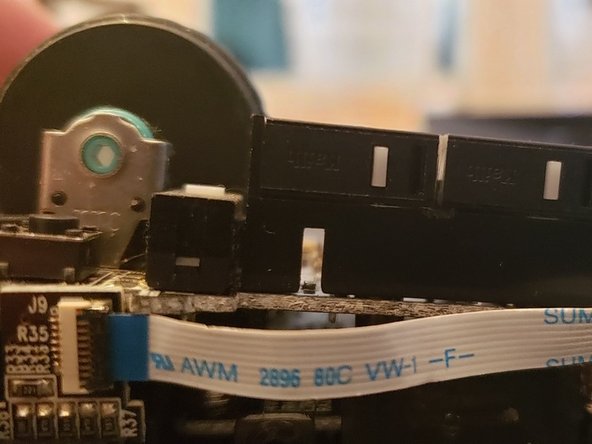

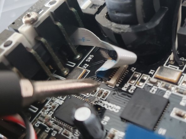

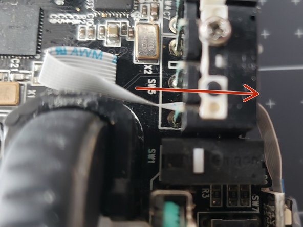

    • Locate two ribbon cables connecting the main board to secondary board.
  8. Razer Mamba RC30-001201 Left/Right Micro Switch Replacement: crwdns2935265:08crwdnd2935265:01crwdnd2935265:03crwdne2935265:0 Razer Mamba RC30-001201 Left/Right Micro Switch Replacement: crwdns2935265:08crwdnd2935265:02crwdnd2935265:03crwdne2935265:0 Razer Mamba RC30-001201 Left/Right Micro Switch Replacement: crwdns2935265:08crwdnd2935265:03crwdnd2935265:03crwdne2935265:0
    • Disconnect the ribbon cables.
    • The second cable must also be routed through the side micro switch housing to get it out.

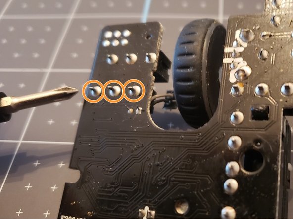

  11. Razer Mamba RC30-001201 Left/Right Micro Switch Replacement: crwdns2935265:011crwdnd2935265:01crwdnd2935265:02crwdne2935265:0 Razer Mamba RC30-001201 Left/Right Micro Switch Replacement: crwdns2935265:011crwdnd2935265:02crwdnd2935265:02crwdne2935265:0
  12. Razer Mamba RC30-001201 Left/Right Micro Switch Replacement: crwdns2935265:012crwdnd2935265:01crwdnd2935265:02crwdne2935265:0 Razer Mamba RC30-001201 Left/Right Micro Switch Replacement: crwdns2935265:012crwdnd2935265:02crwdnd2935265:02crwdne2935265:0

    • Place the new switches in place one at a time.
    • Bend the pins outward slightly to help keep the switch in place, or use a tool like a forceps or a clamp to keep the micro switch from moving.

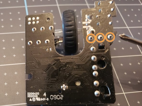

    • Solder the pins for the new micro switch to the board.
    • Get your iron up to temp. 400C degrees.
    • Tin your iron by placing a small amount of solder on the tip of the iron.
    • Heat up the joint by placing the tip of your iron against the intersection of base of the circuit pad, and pin [joint]. After 3-5 seconds it should be sufficiently heated.
    • Continue to hold the soldering iron on the pad, and pin and touch your solder to the joint.
    • A well made joint is smooth and shiny. A cone shape, like a volcano. Repeat process for other pins.

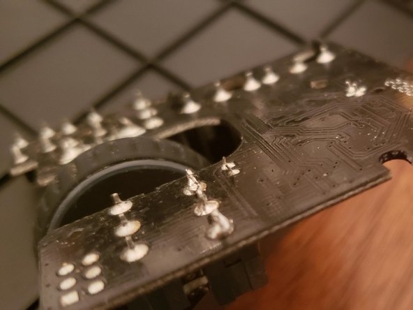

  15. Razer Mamba RC30-001201 Left/Right Micro Switch Replacement: crwdns2935265:015crwdnd2935265:01crwdnd2935265:02crwdne2935265:0 Razer Mamba RC30-001201 Left/Right Micro Switch Replacement: crwdns2935265:015crwdnd2935265:02crwdnd2935265:02crwdne2935265:0
    • One way to judge the quality of a solder joint is the shape it should be a coneish shape extending outward from the base (from the board towards the end of the pins rather than say a ballish shape).
    • Another is luster; a good joint should be shiny. A dusty or more matte looking joint may have been created at the wrong temperature. Does the solder cover the circuit well and is it connected to the pin properly?
