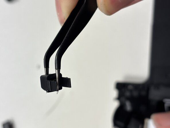

  3. Razer Kishi V2 Pro M1 M2 Bumper Replacement, M1 M2 Bumper: crwdns2935265:03crwdnd2935265:01crwdnd2935265:01crwdne2935265:0
    • During the disassembly of the front panel, the small M1 and M2 buttons might have fallen out of place. If they did, skip the next step.
  4. Razer Kishi V2 Pro M1 M2 Bumper Replacement: crwdns2935265:04crwdnd2935265:01crwdnd2935265:02crwdne2935265:0 Razer Kishi V2 Pro M1 M2 Bumper Replacement: crwdns2935265:04crwdnd2935265:02crwdnd2935265:02crwdne2935265:0
    • Pull on the small M1 or M2 button to remove it from the controller.
    • When inserting the M1 or M2 button back in its slot, make sure the spring is not fully extended when sliding back in.
