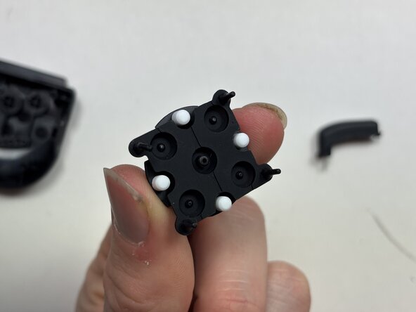

  3. Razer Kishi V2 Pro D-Pad Replacement, D-Pad: crwdns2935265:03crwdnd2935265:01crwdnd2935265:02crwdne2935265:0 Razer Kishi V2 Pro D-Pad Replacement, D-Pad: crwdns2935265:03crwdnd2935265:02crwdnd2935265:02crwdne2935265:0
    • Using tweezers or your fingers, remove the D-pad from the silicone pad.
    • Make sure not to pull out the silicone pad.
