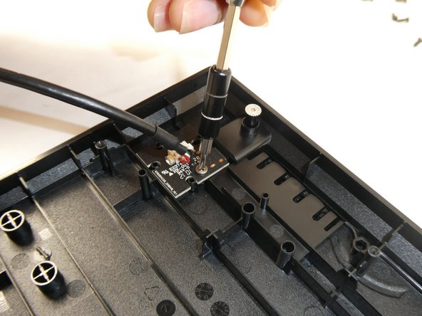

  9. Razer Huntsman Tournament Edition Port Replacement, Port: crwdns2935265:09crwdnd2935265:01crwdnd2935265:02crwdne2935265:0 Razer Huntsman Tournament Edition Port Replacement, Port: crwdns2935265:09crwdnd2935265:02crwdnd2935265:02crwdne2935265:0
    • Unscrew the board with the port.
    • It should be located on the upper left, held in by two 6.5mm Phillips #0 screws.
    • Move the cable out of the way for the second screw
  10. Razer Huntsman Tournament Edition Port Replacement: crwdns2935265:010crwdnd2935265:01crwdnd2935265:01crwdne2935265:0
    • Detach the internal cable from the USB board.
    • Do this carefully.
  11. Razer Huntsman Tournament Edition Port Replacement: crwdns2935265:011crwdnd2935265:01crwdnd2935265:01crwdne2935265:0
    • Remove the USB board.
