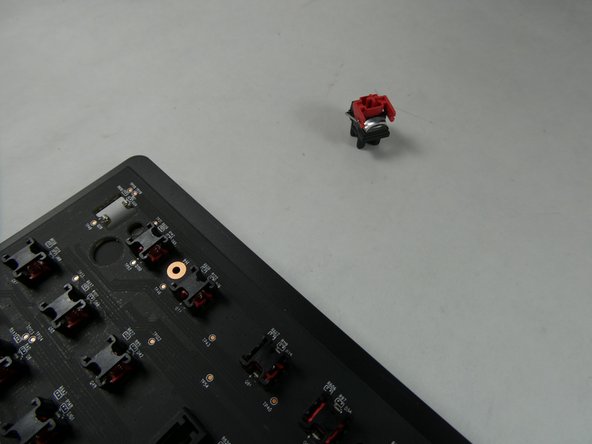

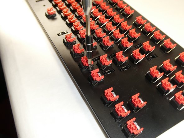

  9. Razer Huntsman Tournament Edition Mainboard Replacement, Key Switch: crwdns2935265:09crwdnd2935265:01crwdnd2935265:02crwdne2935265:0 Razer Huntsman Tournament Edition Mainboard Replacement, Key Switch: crwdns2935265:09crwdnd2935265:02crwdnd2935265:02crwdne2935265:0
    • Gently push the key switch off of the mainboard with your thumb.

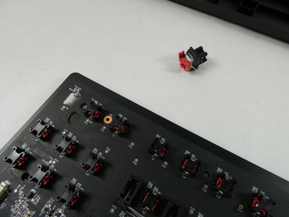

  10. Razer Huntsman Tournament Edition Mainboard Replacement, Mainboard: crwdns2935265:010crwdnd2935265:01crwdnd2935265:02crwdne2935265:0 Razer Huntsman Tournament Edition Mainboard Replacement, Mainboard: crwdns2935265:010crwdnd2935265:02crwdnd2935265:02crwdne2935265:0
    • Remove all of the switches.
  11. Razer Huntsman Tournament Edition Mainboard Replacement: crwdns2935265:011crwdnd2935265:01crwdnd2935265:01crwdne2935265:0
    • Replace the motherboard.
    • Do this in a gentle manner
