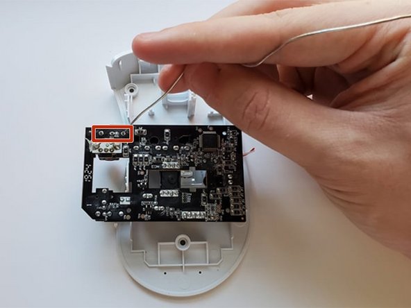

  3. Razer Deathadder Essential RZ01-0254 Mouse Buttons Replacement: crwdns2935265:03crwdnd2935265:01crwdnd2935265:03crwdne2935265:0 Razer Deathadder Essential RZ01-0254 Mouse Buttons Replacement: crwdns2935265:03crwdnd2935265:02crwdnd2935265:03crwdne2935265:0 Razer Deathadder Essential RZ01-0254 Mouse Buttons Replacement: crwdns2935265:03crwdnd2935265:03crwdnd2935265:03crwdne2935265:0
    • Open the mouse, and use the Phillips #1 screwdriver remove the two 11 mm screws that are located on the left side of the motherboard.
    • Also, remove the single 4 mm screw next to the mouse wheel using the Phillips #1 screwdriver.
    • After you remove all three screws the motherboard should be free.

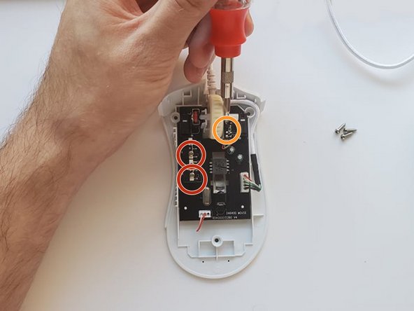

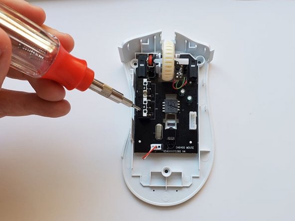

  4. Razer Deathadder Essential RZ01-0254 Mouse Buttons Replacement: crwdns2935265:04crwdnd2935265:01crwdnd2935265:02crwdne2935265:0 Razer Deathadder Essential RZ01-0254 Mouse Buttons Replacement: crwdns2935265:04crwdnd2935265:02crwdnd2935265:02crwdne2935265:0
    • This is the component that we will be replacing and its 3 contact points.

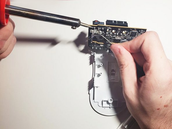

  5. Razer Deathadder Essential RZ01-0254 Mouse Buttons Replacement: crwdns2935265:05crwdnd2935265:01crwdnd2935265:01crwdne2935265:0
    Desoldering Pump
    $3.99
    • Using your soldering iron and desoldering pump, desolder the 3 contact points that attach to each button as marked.
    • Be careful when using a soldering iron, as it can burn you if not used correctly.

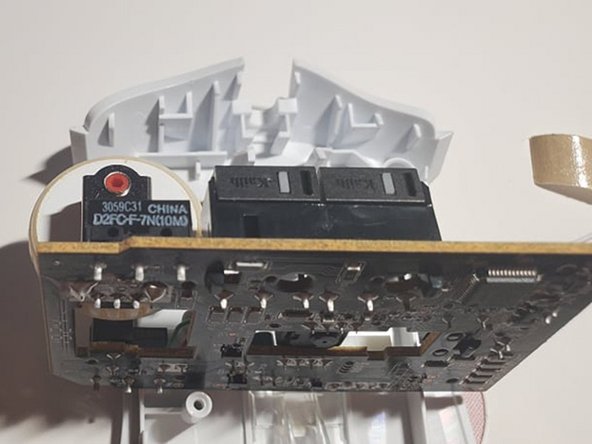

  6. Razer Deathadder Essential RZ01-0254 Mouse Buttons Replacement: crwdns2935265:06crwdnd2935265:01crwdnd2935265:03crwdne2935265:0 Razer Deathadder Essential RZ01-0254 Mouse Buttons Replacement: crwdns2935265:06crwdnd2935265:02crwdnd2935265:03crwdne2935265:0 Razer Deathadder Essential RZ01-0254 Mouse Buttons Replacement: crwdns2935265:06crwdnd2935265:03crwdnd2935265:03crwdne2935265:0
    • Remove the button that you just desoldered.
    • Then solder the new button back into place. Repeat for both buttons.
