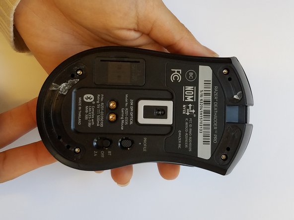

    • Turn the mouse over so that the writing on the bottom faces up.
  2. Razer DeathAdder V2 Pro Battery Replacement: crwdns2935265:02crwdnd2935265:01crwdnd2935265:01crwdne2935265:0
    • Use a spudger to remove the three pads on the bottom of the mouse.
  3. Razer DeathAdder V2 Pro Battery Replacement: crwdns2935265:03crwdnd2935265:01crwdnd2935265:02crwdne2935265:0 Razer DeathAdder V2 Pro Battery Replacement: crwdns2935265:03crwdnd2935265:02crwdnd2935265:02crwdne2935265:0
    • Remove the four 1.2 mm screws from each corner of the mouse using a T6 Torx screwdriver.

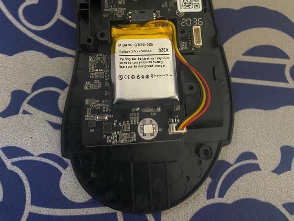

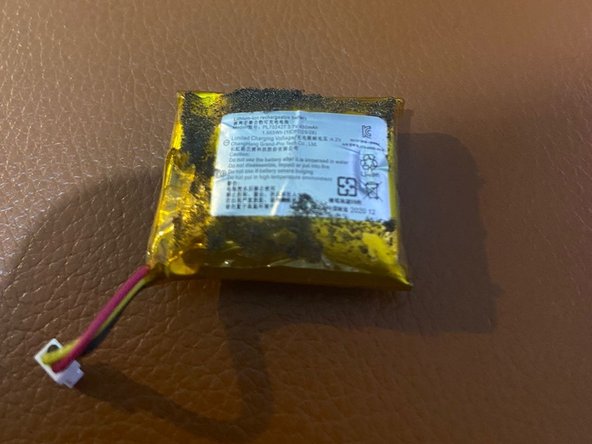

    • Remove the three 1 mm screws that hold the battery to the circuit board using a Phillips #1 screwdriver.
    • Remove the battery from the mouse.
  9. Razer DeathAdder V2 Pro Battery Replacement: crwdns2935265:09crwdnd2935265:01crwdnd2935265:02crwdne2935265:0 Razer DeathAdder V2 Pro Battery Replacement: crwdns2935265:09crwdnd2935265:02crwdnd2935265:02crwdne2935265:0
    • the original battery and new battery instaled.

In case someone is in the same boat as me:
The original was a 3.7v 450mah battery.
I put in a 1500mah, 3.7v LOSONCOER battery, but also saw a 450 variant on AliExpress. The only problem with the losoncoer is that wasn't the same connector as the original, the losoncoer one was slimmer, so it was a bit odd and only worked with a lot of tinkering, but the guide is perfect!
