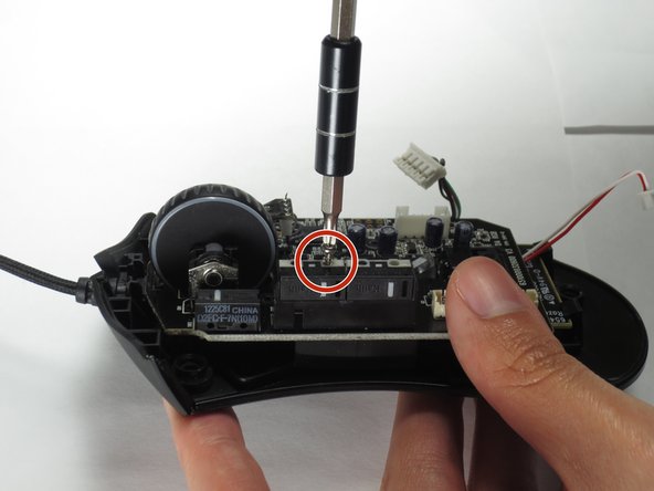

  11. Razer DeathAdder Chroma Scroll Wheel Replacement: crwdns2935265:011crwdnd2935265:01crwdnd2935265:01crwdne2935265:0
    • Use a Phillips #000 screwdriver to remove one 5.0 mm screw.
  12. Razer DeathAdder Chroma Scroll Wheel Replacement: crwdns2935265:012crwdnd2935265:01crwdnd2935265:02crwdne2935265:0 Razer DeathAdder Chroma Scroll Wheel Replacement: crwdns2935265:012crwdnd2935265:02crwdnd2935265:02crwdne2935265:0
