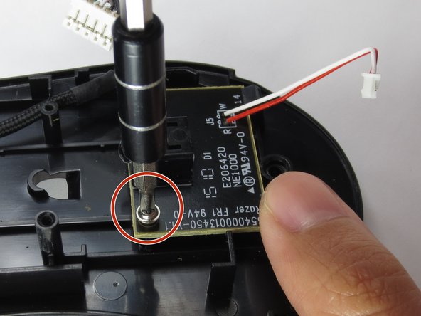

  14. Razer DeathAdder Chroma Optical Sensor Replacement, Optical Sensor: crwdns2935265:014crwdnd2935265:01crwdnd2935265:02crwdne2935265:0 Razer DeathAdder Chroma Optical Sensor Replacement, Optical Sensor: crwdns2935265:014crwdnd2935265:02crwdnd2935265:02crwdne2935265:0
    • Use a Phillips #0 screwdriver to remove two 5.5mm screws.

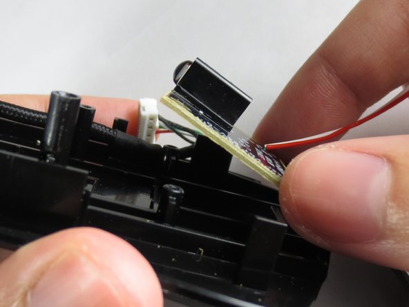

  15. Razer DeathAdder Chroma Optical Sensor Replacement: crwdns2935265:015crwdnd2935265:01crwdnd2935265:02crwdne2935265:0 Razer DeathAdder Chroma Optical Sensor Replacement: crwdns2935265:015crwdnd2935265:02crwdnd2935265:02crwdne2935265:0
    • Remove the optical sensor by pulling it forward and up.

This is not a sensor, but a sensor backlight. Sensor on the underside of the main board
