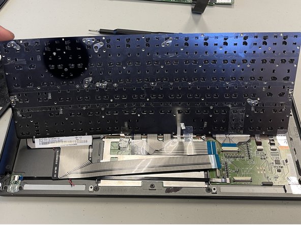

  9. Razer Blade Stealth 2017 Touchpad Replacement, Touchpad: crwdns2935265:09crwdnd2935265:01crwdnd2935265:02crwdne2935265:0 Razer Blade Stealth 2017 Touchpad Replacement, Touchpad: crwdns2935265:09crwdnd2935265:02crwdnd2935265:02crwdne2935265:0
    • Use a Phillips #000 to remove all 55 1.6 mm screws from the metal plate.
    • Remove the metal plate from computer using your hands.

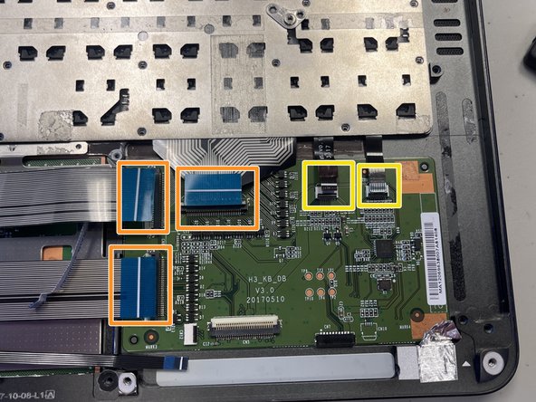

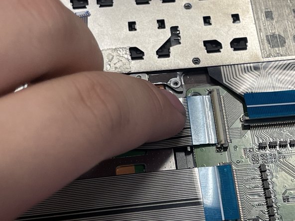

  10. Razer Blade Stealth 2017 Touchpad Replacement: crwdns2935265:010crwdnd2935265:01crwdnd2935265:03crwdne2935265:0 Razer Blade Stealth 2017 Touchpad Replacement: crwdns2935265:010crwdnd2935265:02crwdnd2935265:03crwdne2935265:0 Razer Blade Stealth 2017 Touchpad Replacement: crwdns2935265:010crwdnd2935265:03crwdnd2935265:03crwdne2935265:0
    • Use a spudger to remove foil tape.
    • Pull the connectors off using fingers
    • Remove the connectors by lifting up the hinges by using fingertips.
    • Pull the connectors off.

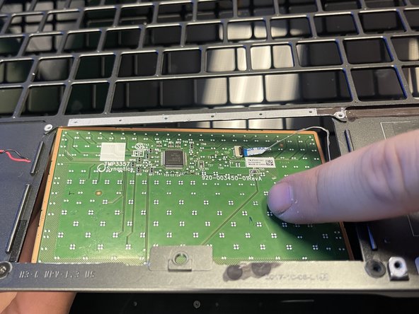

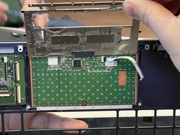

    • Pull the connector off from the mousepad connected to the daughterboard.
    • Use a Jimmy to remove adhesive from the metal bracket on the mousepad.
    • To remove adhesive, warm the area up that has adhesive.
    • Pull up on the metal bracket after removing adhesive.
    • Push down on the mousepad to remove from the computer.
