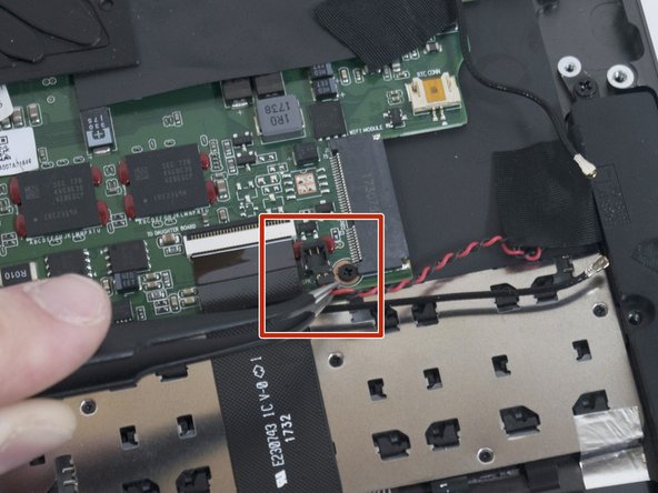

  6. Razer Blade Stealth 2017 Speaker Replacement, Speaker: crwdns2935265:06crwdnd2935265:01crwdnd2935265:02crwdne2935265:0 Razer Blade Stealth 2017 Speaker Replacement, Speaker: crwdns2935265:06crwdnd2935265:02crwdnd2935265:02crwdne2935265:0
    • Use tweezers to disconnect the red and black speaker cables by lifting up on the pin-header.
    • The same process is used for both speaker connections.
    • Do not pull horizontally on the wires!

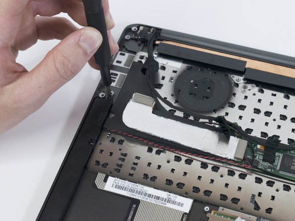

  7. Razer Blade Stealth 2017 Speaker Replacement: crwdns2935265:07crwdnd2935265:01crwdnd2935265:02crwdne2935265:0 Razer Blade Stealth 2017 Speaker Replacement: crwdns2935265:07crwdnd2935265:02crwdnd2935265:02crwdne2935265:0
    • Use a Phillips #00 to remove the two, 4mm screws on each speaker.

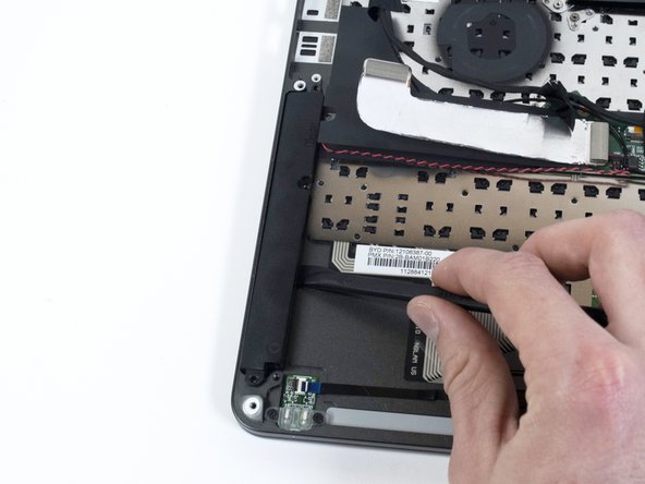

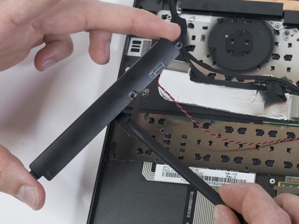

  8. Razer Blade Stealth 2017 Speaker Replacement: crwdns2935265:08crwdnd2935265:01crwdnd2935265:03crwdne2935265:0 Razer Blade Stealth 2017 Speaker Replacement: crwdns2935265:08crwdnd2935265:02crwdnd2935265:03crwdne2935265:0 Razer Blade Stealth 2017 Speaker Replacement: crwdns2935265:08crwdnd2935265:03crwdnd2935265:03crwdne2935265:0
    • Use a plastic spudger to pry the speaker(s) away from the chassis.
    • The speakers are glued to the chassis, making them difficult to remove.
    • The same process is used for both speakers.
