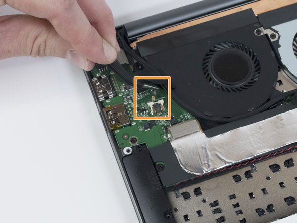

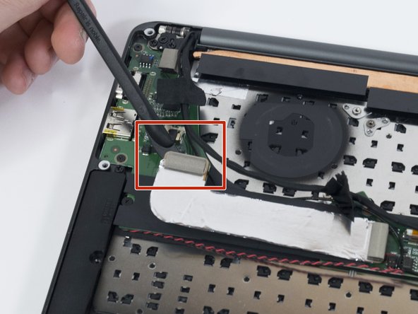

    • Use a plastic spudger to lift up the press-fit interconnect cable and expose the USB-A and HDMI port module.
  7. Razer Blade Stealth 2017 HDMI and USB-A Port Replacement: crwdns2935265:07crwdnd2935265:01crwdnd2935265:02crwdne2935265:0 Razer Blade Stealth 2017 HDMI and USB-A Port Replacement: crwdns2935265:07crwdnd2935265:02crwdnd2935265:02crwdne2935265:0
    • Use tweezers to squeeze the fan's white header.
    • Disconnect the fan connector by sliding it out toward the rear of the chassis.
  8. Razer Blade Stealth 2017 HDMI and USB-A Port Replacement: crwdns2935265:08crwdnd2935265:01crwdnd2935265:02crwdne2935265:0 Razer Blade Stealth 2017 HDMI and USB-A Port Replacement: crwdns2935265:08crwdnd2935265:02crwdnd2935265:02crwdne2935265:0

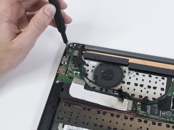

    • Use a Phillips #00 screwdriver to remove the two, 3mm screws from the USB-A and HDMI port module.
  9. Razer Blade Stealth 2017 HDMI and USB-A Port Replacement: crwdns2935265:09crwdnd2935265:01crwdnd2935265:01crwdne2935265:0
    • Use a plastic spudger to remove the USB-A and HDMI port module from the case.
    • Do not damage the interconnect cable during removal!
