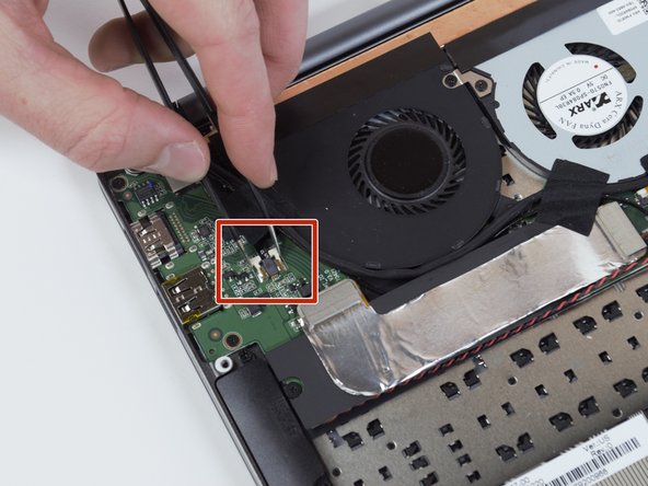

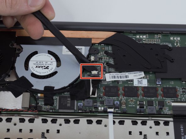

    • Use a plastic spudger to lift the white clasp on the fan connector.
  7. Razer Blade Stealth 2017 Fan Replacement: crwdns2935265:07crwdnd2935265:01crwdnd2935265:01crwdne2935265:0
    • Use tweezers to pull the fan cable out of the opened connector terminal.

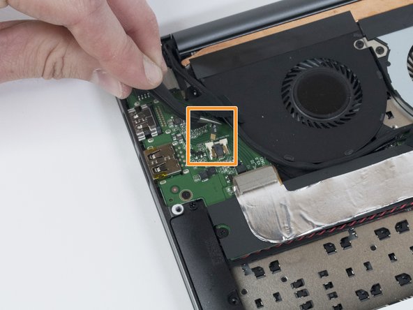

    • Use tweezers to squeeze the fan's white header.
    • Disconnect the fan connector by sliding it out toward the rear of the chassis.

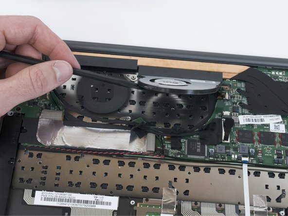

    • Remove any tape attached to the fans.
    • Use a Phillips #00 screwdriver to remove the six, 3mm screws and the metal bracket around both fans.
  10. Razer Blade Stealth 2017 Fan Replacement: crwdns2935265:010crwdnd2935265:01crwdnd2935265:02crwdne2935265:0 Razer Blade Stealth 2017 Fan Replacement: crwdns2935265:010crwdnd2935265:02crwdnd2935265:02crwdne2935265:0
    • Use a plastic spudger to slide the fans out of the case.
