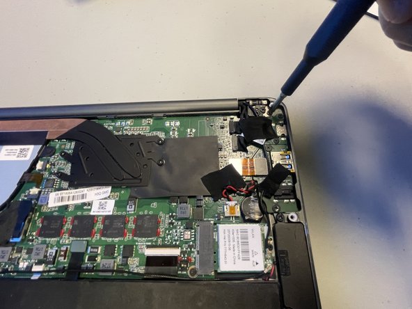

    • Use a Phillips #00 screwdriver to remove the six 4 mm screws securing the display assembly.
  7. Razer Blade Stealth 2017 Display Assembly Replacement: crwdns2935265:07crwdnd2935265:01crwdnd2935265:03crwdne2935265:0 Razer Blade Stealth 2017 Display Assembly Replacement: crwdns2935265:07crwdnd2935265:02crwdnd2935265:03crwdne2935265:0 Razer Blade Stealth 2017 Display Assembly Replacement: crwdns2935265:07crwdnd2935265:03crwdnd2935265:03crwdne2935265:0

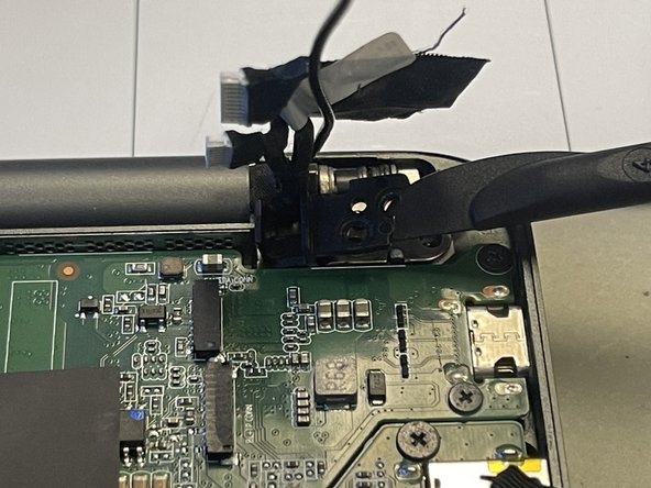

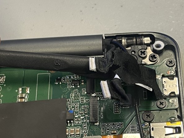

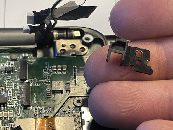

    • Use the plastic spudger to remove the plastic brackets beneath the hinges.
  8. Razer Blade Stealth 2017 Display Assembly Replacement: crwdns2935265:08crwdnd2935265:01crwdnd2935265:02crwdne2935265:0 Razer Blade Stealth 2017 Display Assembly Replacement: crwdns2935265:08crwdnd2935265:02crwdnd2935265:02crwdne2935265:0

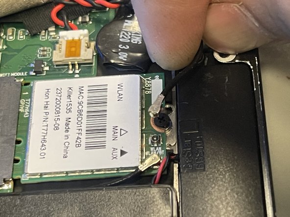

    • Remove any tape attached to the wires.
    • Use the plastic spudger to slide the connectors to the right to disconnect them.
  9. Razer Blade Stealth 2017 Display Assembly Replacement: crwdns2935265:09crwdnd2935265:01crwdnd2935265:02crwdne2935265:0 Razer Blade Stealth 2017 Display Assembly Replacement: crwdns2935265:09crwdnd2935265:02crwdnd2935265:02crwdne2935265:0

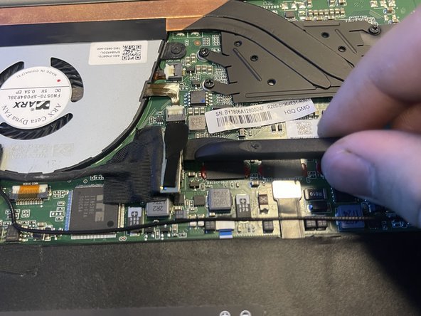

    • Use the plastic spudger to lift the connector off of the socket.
  10. Razer Blade Stealth 2017 Display Assembly Replacement: crwdns2935265:010crwdnd2935265:01crwdnd2935265:02crwdne2935265:0 Razer Blade Stealth 2017 Display Assembly Replacement: crwdns2935265:010crwdnd2935265:02crwdnd2935265:02crwdne2935265:0
    • Use your fingers to lift connectors off of their sockets.
  11. Razer Blade Stealth 2017 Display Assembly Replacement: crwdns2935265:011crwdnd2935265:01crwdnd2935265:02crwdne2935265:0 Razer Blade Stealth 2017 Display Assembly Replacement: crwdns2935265:011crwdnd2935265:02crwdnd2935265:02crwdne2935265:0

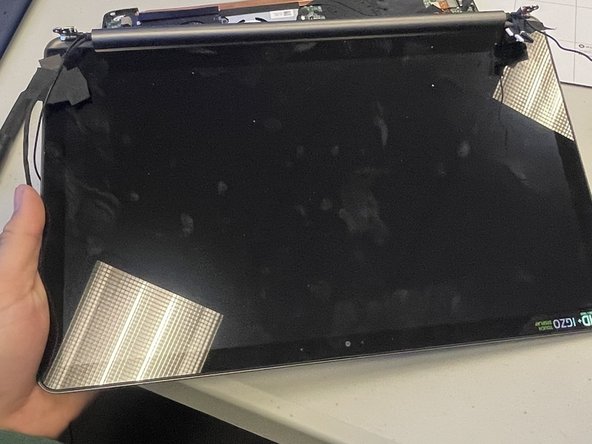

    • Lift the screen to the open position.
    • Remove the display assembly by sliding it away from the keyboard.
    • Do not force the display assembly off!
