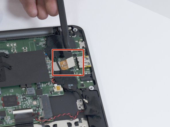

  6. Razer Blade Stealth 2017 Audio and USB-A Port Replacement, Audio and USB-A Port: crwdns2935265:06crwdnd2935265:01crwdnd2935265:02crwdne2935265:0 Razer Blade Stealth 2017 Audio and USB-A Port Replacement, Audio and USB-A Port: crwdns2935265:06crwdnd2935265:02crwdnd2935265:02crwdne2935265:0
    • Use a plastic spudger to lift up the module connector.
