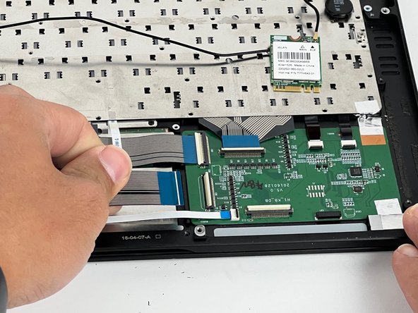

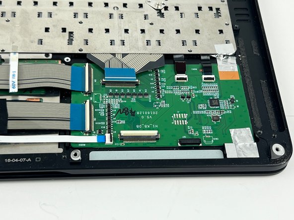

  9. Razer Blade Stealth 2016 Keyboard Replacement, Keyboard: crwdns2935265:09crwdnd2935265:01crwdnd2935265:03crwdne2935265:0 Razer Blade Stealth 2016 Keyboard Replacement, Keyboard: crwdns2935265:09crwdnd2935265:02crwdnd2935265:03crwdne2935265:0 Razer Blade Stealth 2016 Keyboard Replacement, Keyboard: crwdns2935265:09crwdnd2935265:03crwdnd2935265:03crwdne2935265:0
    • Flip all white tabs up to unlock three ZIF connectors using the opening tool.
    • Flip all black tabs up to unlock the three ZIF connectors using the opening tool.
    • This is how the tabs look in the flipped up position.
  10. Razer Blade Stealth 2016 Keyboard Replacement: crwdns2935265:010crwdnd2935265:01crwdnd2935265:03crwdne2935265:0 Razer Blade Stealth 2016 Keyboard Replacement: crwdns2935265:010crwdnd2935265:02crwdnd2935265:03crwdne2935265:0 Razer Blade Stealth 2016 Keyboard Replacement: crwdns2935265:010crwdnd2935265:03crwdnd2935265:03crwdne2935265:0
    • Pull the cables out gently.

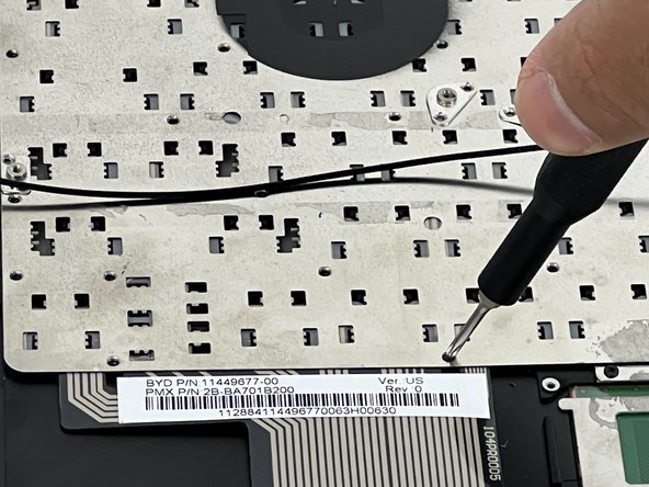

    • Remove fifty-five 3.4 mm keyboard screws with the T5 Torx screwdriver.
    • 5 screw locations are highlighted but locate all 55 screws and remove them.

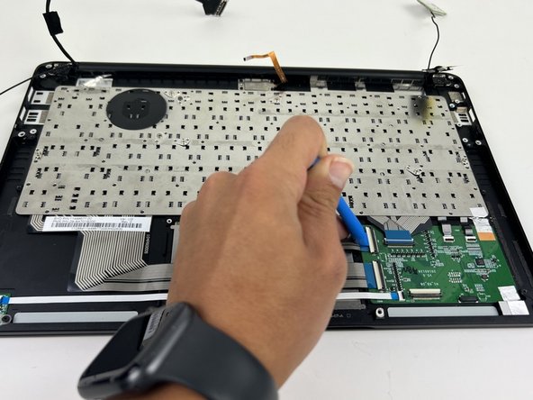

  12. Razer Blade Stealth 2016 Keyboard Replacement: crwdns2935265:012crwdnd2935265:01crwdnd2935265:03crwdne2935265:0 Razer Blade Stealth 2016 Keyboard Replacement: crwdns2935265:012crwdnd2935265:02crwdnd2935265:03crwdne2935265:0 Razer Blade Stealth 2016 Keyboard Replacement: crwdns2935265:012crwdnd2935265:03crwdnd2935265:03crwdne2935265:0
    • Remove the keyboard from the laptop.
