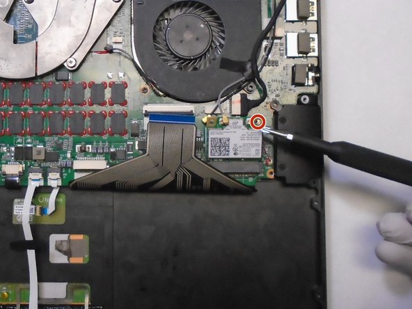

    • Use a Phillips #0 screwdriver to remove the single 3 mm screw from the upper-right corner of the Wi-Fi card.
