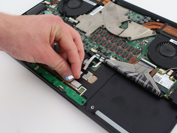

  3. Razer Blade RZ09-0130 2015 Trackpad Button Replacement, Trackpad Button: crwdns2935265:03crwdnd2935265:01crwdnd2935265:03crwdne2935265:0 Razer Blade RZ09-0130 2015 Trackpad Button Replacement, Trackpad Button: crwdns2935265:03crwdnd2935265:02crwdnd2935265:03crwdne2935265:0 Razer Blade RZ09-0130 2015 Trackpad Button Replacement, Trackpad Button: crwdns2935265:03crwdnd2935265:03crwdnd2935265:03crwdne2935265:0
    • Detach the two connectors from the motherboard by gently pulling them directly out of their ports with your fingers.

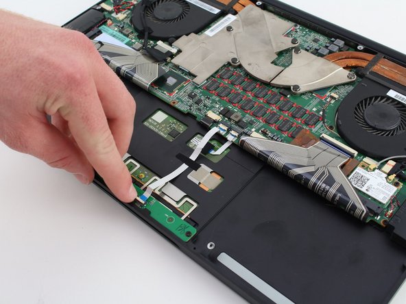

  4. Razer Blade RZ09-0130 2015 Trackpad Button Replacement: crwdns2935265:04crwdnd2935265:01crwdnd2935265:02crwdne2935265:0 Razer Blade RZ09-0130 2015 Trackpad Button Replacement: crwdns2935265:04crwdnd2935265:02crwdnd2935265:02crwdne2935265:0
    • Use a Phillips #1 screwdriver to remove the two 3 mm screws holding the trackpad's circuit board to the chassis.
  5. Razer Blade RZ09-0130 2015 Trackpad Button Replacement: crwdns2935265:05crwdnd2935265:01crwdnd2935265:01crwdne2935265:0
    • Remove the trackpad circuit board by holding one end and gently lifting it upwards.
