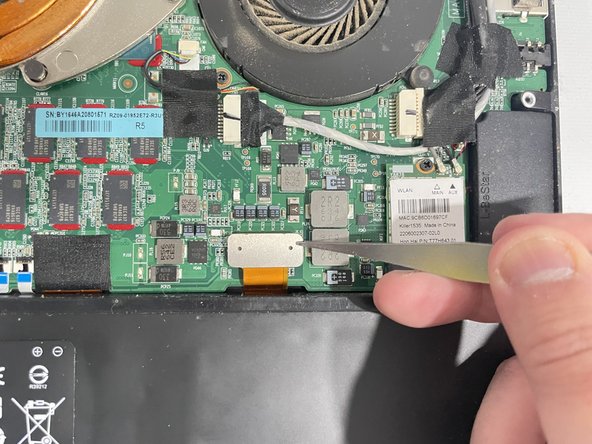

  4. Razer Blade 2014 Battery Replacement: crwdns2935265:04crwdnd2935265:01crwdnd2935265:02crwdne2935265:0 Razer Blade 2014 Battery Replacement: crwdns2935265:04crwdnd2935265:02crwdnd2935265:02crwdne2935265:0
    • Use tweezers to detach the silver connector that is attached to the battery with an orange cable.

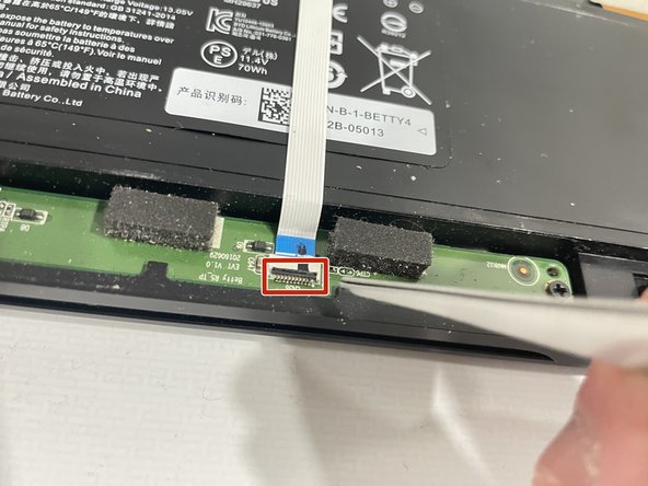

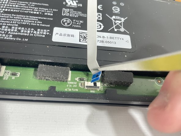

  5. Razer Blade 2014 Battery Replacement: crwdns2935265:05crwdnd2935265:01crwdnd2935265:03crwdne2935265:0 Razer Blade 2014 Battery Replacement: crwdns2935265:05crwdnd2935265:02crwdnd2935265:03crwdne2935265:0 Razer Blade 2014 Battery Replacement: crwdns2935265:05crwdnd2935265:03crwdnd2935265:03crwdne2935265:0
    • Make sure the black cable retaining flap has been completely lifted upwards before pulling the blue cable outwards.
    • Use tweezers to gently lift the retaining flap upwards.
    • Use tweezers to gently pull the white cable outward.
