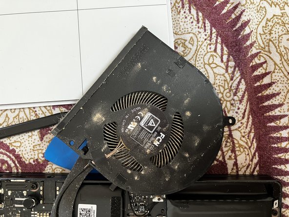

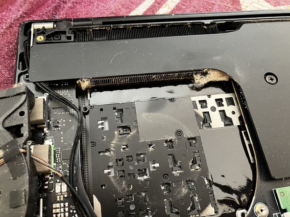

For my particular case this Razer is around 18 months old and regularly experienced thermal throttling hitting core temps above 100*C. As you will see below the fan and heatsink were very dirty. Following the instructions of this guide, we managed to lower the running temperature to around 85*C. So, it's well worth to do it!

There are two Philips screws in each fan. Remove them
One is easily visible.
The other one is under the black plastic cover (see orange markers)
Do this on both fans

Use the brush and dust blower to clean the fans
You might also use the tweezers to remove debris

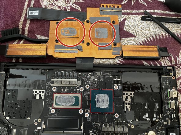

There are 10 Philips screws with a spring. Unfasten them
Now lift the heatsink carefully. The thermal paste offers more resistance than normal.
The heatsink is a heavy, copper metal component.
Use a micro fibre cloth with alcohol to remove the thermal paste on the GPU, CPU and the heatsink
Reapply thermal paste on CPU and GPU. (red squares)
Put the heatsink back and fasten it
