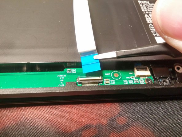

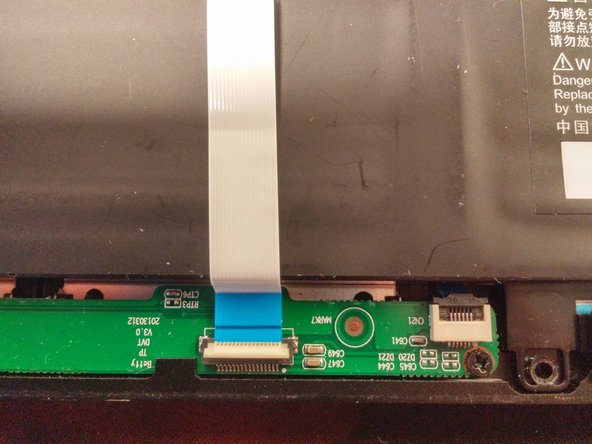

  3. Razer Blade 14" (2013) Battery Replacement, Remove Touchpad cable: crwdns2935265:03crwdnd2935265:01crwdnd2935265:03crwdne2935265:0 Razer Blade 14" (2013) Battery Replacement, Remove Touchpad cable: crwdns2935265:03crwdnd2935265:02crwdnd2935265:03crwdne2935265:0 Razer Blade 14" (2013) Battery Replacement, Remove Touchpad cable: crwdns2935265:03crwdnd2935265:03crwdnd2935265:03crwdne2935265:0
    • Unclip hold-down
    • Remove cable

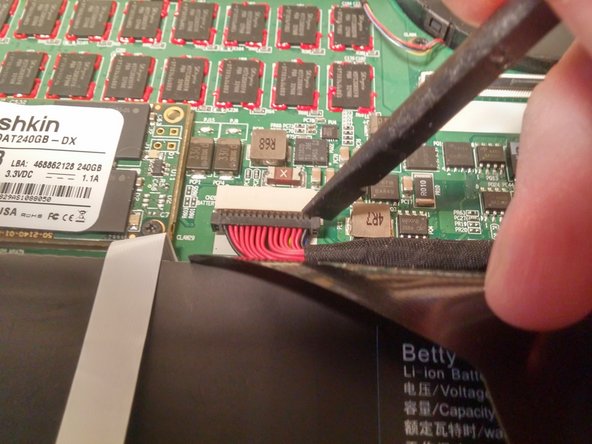

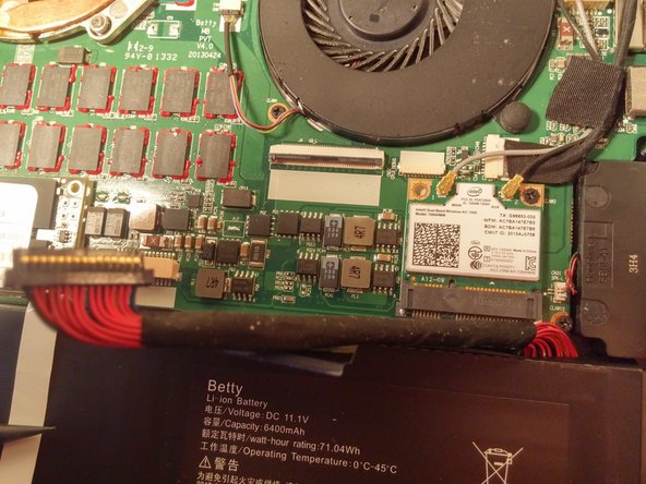

  4. Razer Blade 14" (2013) Battery Replacement, Disconnect Battery: crwdns2935265:04crwdnd2935265:01crwdnd2935265:03crwdne2935265:0 Razer Blade 14" (2013) Battery Replacement, Disconnect Battery: crwdns2935265:04crwdnd2935265:02crwdnd2935265:03crwdne2935265:0 Razer Blade 14" (2013) Battery Replacement, Disconnect Battery: crwdns2935265:04crwdnd2935265:03crwdnd2935265:03crwdne2935265:0
    • Use a spudger to disconnect the plug from the connector by pulling it away from the socket, parallel to the board.
    • Bend the connector backwards to prevent it from getting in the way of the motherboard.

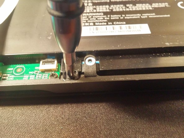

  5. Razer Blade 14" (2013) Battery Replacement, Remove Battery Screws: crwdns2935265:05crwdnd2935265:01crwdnd2935265:02crwdne2935265:0 Razer Blade 14" (2013) Battery Replacement, Remove Battery Screws: crwdns2935265:05crwdnd2935265:02crwdnd2935265:02crwdne2935265:0
    • Remove the 7 battery screws

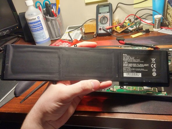

  6. Razer Blade 14" (2013) Battery Replacement, Remove the Battery: crwdns2935265:06crwdnd2935265:01crwdnd2935265:02crwdne2935265:0 Razer Blade 14" (2013) Battery Replacement, Remove the Battery: crwdns2935265:06crwdnd2935265:02crwdnd2935265:02crwdne2935265:0
    • Remove the battery by pulling up from the side closest to the motherboard
    • Be careful of the other cables and the battery cable
    • You will have to lift up just a bit, then slide forward to clear one cable and the back cover screws

tallme15 -
May I have a detailed guide on how you remove the cable over the battery, please? I am not used to taking machines apart, and wouldn't want to risk ruining my laptop. (didn't quite understand your pictures)
ceci - crwdns2934203:0crwdne2934203:0
The only way to remove the cable is to work it out with a set of tweezers and be gentle not to pull the cables lose from the connector.
