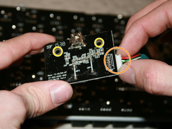

    • Remove the four plastic covers and rubber feet from all four corners of the keyboard.
    • Remove the four screws.
    • Carefully pry around the bottom end of the keyboard and work your way around keyboard to un-clip the face.
  2. Razer Blackwidow Tournament Edition Keyboard USB Port Board Replacement: crwdns2935265:02crwdnd2935265:01crwdnd2935265:02crwdne2935265:0 Razer Blackwidow Tournament Edition Keyboard USB Port Board Replacement: crwdns2935265:02crwdnd2935265:02crwdnd2935265:02crwdne2935265:0
    • Turn the keyboard face up.
    • Remove the four screws which attach the keys.
    • Note the orientation of the white plastic cover relative to the LED at the bottom of the board.
  3. Razer Blackwidow Tournament Edition Keyboard USB Port Board Replacement: crwdns2935265:03crwdnd2935265:01crwdnd2935265:01crwdne2935265:0
    • Locate the USB at the top of the device.
    • Remove the two screws attaching the USB.
  4. Razer Blackwidow Tournament Edition Keyboard USB Port Board Replacement: crwdns2935265:04crwdnd2935265:01crwdnd2935265:02crwdne2935265:0 Razer Blackwidow Tournament Edition Keyboard USB Port Board Replacement: crwdns2935265:04crwdnd2935265:02crwdnd2935265:02crwdne2935265:0
    • Unplug the cable connecting to the USB board.
    • Plug the new USB board into the slot.
    • Replace the screws in the USB board.
