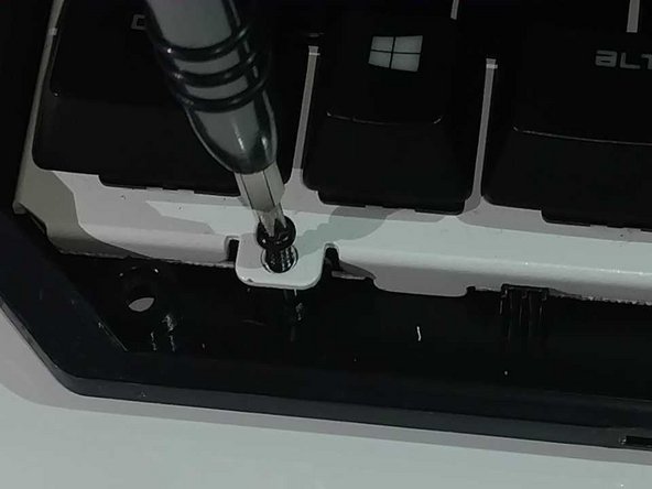

    • Use a Phillips #1 screwdriver to remove the six screws on the back of the keyboard.
    • Use an opening tool as a wedge between the front and back panel to pry open the front panel.
    • If the front and back panel won't separate, DO NOT use excessive force. This may result in damaging the keyboard.
    • Instead, slide the opening tool across the keyboard in between the front and back panel. Go around the edges of the keyboard until the panels disconnect.
    • Flip the keyboard over so the keys are facing up.
    • Grabbing the left and right lips of the front panel, lift both ends up, removing the front panel.

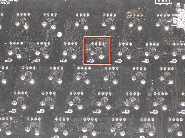

    • De-solder the anchor of each key that you desire to replace with a soldering iron.
    • For more information on soldering connections, please visit the How to Solder and Desolder Connections guide.
    • Remove the key switch once the de-soldering is complete.
