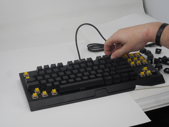

    • Before you begin, unplug the keyboard from your computer to prevent accidental damage.
    • Use a keycap puller to remove all keycaps.

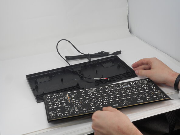

  3. Razer BlackWidow V3 Tenkeyless USB Cable/Back Panel Replacement: crwdns2935265:03crwdnd2935265:01crwdnd2935265:02crwdne2935265:0 Razer BlackWidow V3 Tenkeyless USB Cable/Back Panel Replacement: crwdns2935265:03crwdnd2935265:02crwdnd2935265:02crwdne2935265:0
    • Carefully separate the backplate from the face plate.
    • Take care not to strain the connected USB cable.
    • A plastic opening tool can be helpful to gently pry the pieces apart if needed.
    • Be patient and work slowly to avoid breaking any clips or the usb-connector.

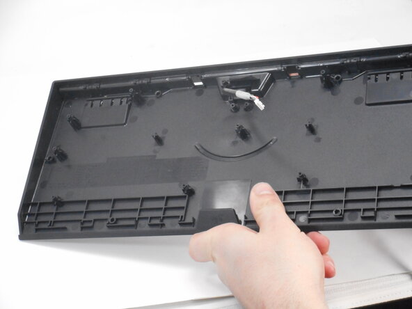

  4. Razer BlackWidow V3 Tenkeyless USB Cable/Back Panel Replacement: crwdns2935265:04crwdnd2935265:01crwdnd2935265:02crwdne2935265:0 Razer BlackWidow V3 Tenkeyless USB Cable/Back Panel Replacement: crwdns2935265:04crwdnd2935265:02crwdnd2935265:02crwdne2935265:0
    • Flip the face plate over and gently disconnect the white USB connector.
    • Pull on the connector, not the cable bundle.

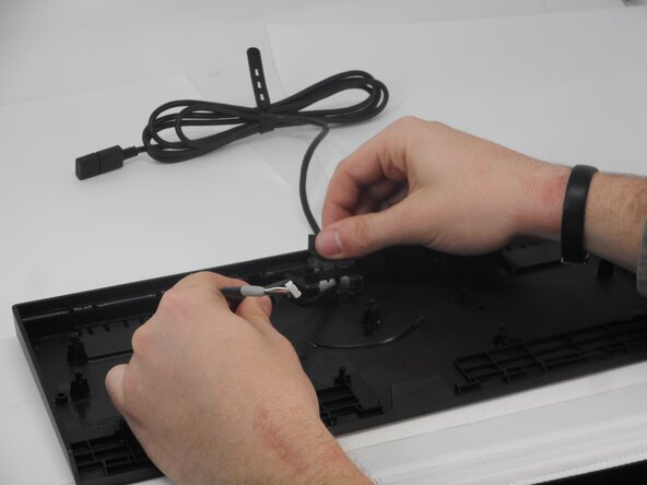

  5. Razer BlackWidow V3 Tenkeyless USB Cable/Back Panel Replacement: crwdns2935265:05crwdnd2935265:01crwdnd2935265:03crwdne2935265:0 Razer BlackWidow V3 Tenkeyless USB Cable/Back Panel Replacement: crwdns2935265:05crwdnd2935265:02crwdnd2935265:03crwdne2935265:0 Razer BlackWidow V3 Tenkeyless USB Cable/Back Panel Replacement: crwdns2935265:05crwdnd2935265:03crwdnd2935265:03crwdne2935265:0
    • Remove the two Phillips #0 screws.
    • Lift the flap and remove the USB cable.
