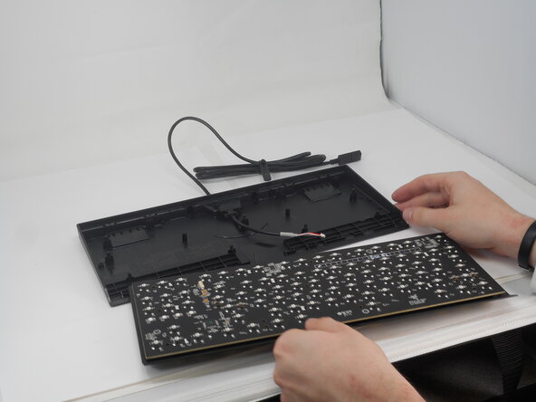

  3. Razer BlackWidow V3 Tenkeyless LED Replacement: crwdns2935265:03crwdnd2935265:01crwdnd2935265:02crwdne2935265:0 Razer BlackWidow V3 Tenkeyless LED Replacement: crwdns2935265:03crwdnd2935265:02crwdnd2935265:02crwdne2935265:0
    • Carefully separate the backplate from the main keyboard body.
    • A plastic opening tool can be helpful to gently pry the pieces apart if needed.
    • Be patient and work slowly to avoid breaking any clips or the usb-connector.

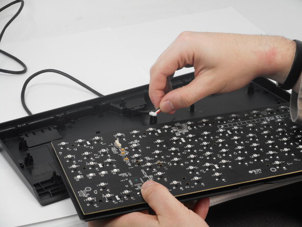

  4. Razer BlackWidow V3 Tenkeyless LED Replacement: crwdns2935265:04crwdnd2935265:01crwdnd2935265:02crwdne2935265:0 Razer BlackWidow V3 Tenkeyless LED Replacement: crwdns2935265:04crwdnd2935265:02crwdnd2935265:02crwdne2935265:0
    • Gently pull out the cable holding the usb connector using your hand.
    • Ensure the cable is pulled straight back to prevent the usb-connector snapping.

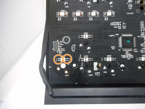

  5. Razer BlackWidow V3 Tenkeyless LED Replacement: crwdns2935265:05crwdnd2935265:01crwdnd2935265:02crwdne2935265:0 Razer BlackWidow V3 Tenkeyless LED Replacement: crwdns2935265:05crwdnd2935265:02crwdnd2935265:02crwdne2935265:0
    • Use a soldering iron to heat the four solder points securing the LED to the board, then apply a solder wick to absorb and remove the melted solder.
    • The soldering process involves high heat—handle the soldering iron carefully to avoid burns or damage to the circuit board.
