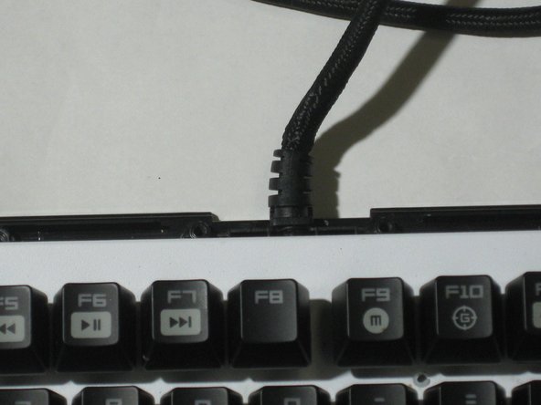

  3. Razer BlackWidow Chroma Wire Harness Replacement, Wire Harness: crwdns2935265:03crwdnd2935265:01crwdnd2935265:01crwdne2935265:0
    • Using a Philips #1 screwdriver, remove all ten screws found on the edges of the keyboard.
    • Two of the screws are found on either side of the main cable.
  4. Razer BlackWidow Chroma Wire Harness Replacement: crwdns2935265:04crwdnd2935265:01crwdnd2935265:02crwdne2935265:0 Razer BlackWidow Chroma Wire Harness Replacement: crwdns2935265:04crwdnd2935265:02crwdnd2935265:02crwdne2935265:0
    • Remove the wire harness.
