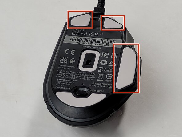

  1. Razer Basilisk V3 Switch Replacement, Skates: crwdns2935265:01crwdnd2935265:01crwdnd2935265:01crwdne2935265:0
    • Locate the highlighted white skates on the bottom of the mouse.
  2. Razer Basilisk V3 Switch Replacement: crwdns2935265:02crwdnd2935265:01crwdnd2935265:03crwdne2935265:0 Razer Basilisk V3 Switch Replacement: crwdns2935265:02crwdnd2935265:02crwdnd2935265:03crwdne2935265:0 Razer Basilisk V3 Switch Replacement: crwdns2935265:02crwdnd2935265:03crwdnd2935265:03crwdne2935265:0
    • Heat the skate using a heat gun or hair dryer.
    • Using the pointy end of the spudger pry away a corner of the skate.
    • If the adhesive does not pull away easily, heat the skate more.
    • Once the corner of the skate comes free use the flat end of the spudger to peel off the rest of the skate.
    • Repeat these steps for each of the skates.
