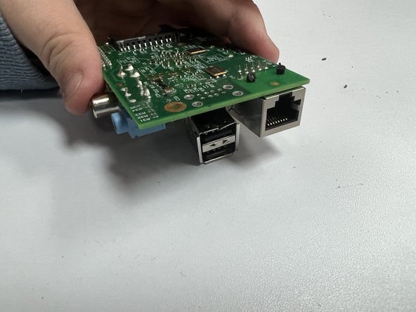

    • Orient the Raspberry Pi so that the port-covered side faces downwards, and the opening of the USB port is visible.
    • Identify the 12 silver USB pins on the lower-middle section of the board.

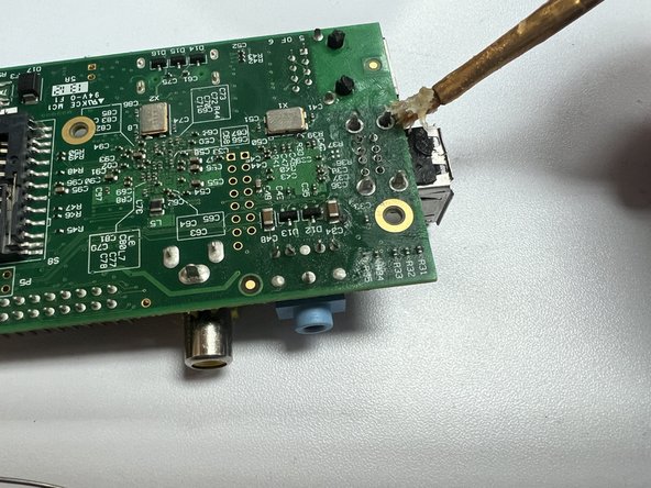

    • Use an inexpensive paint brush, or the applicator that came with the flux, to apply flux around the 12 pins on the printed circuit board (PCB).
    • Be sure to coat flux on what you don’t want to be covered in solder.

    • Soldering/desoldering presents potential for device damage and burns.
    • Starting with the largest pins first, but individually, use the soldering iron to carefully melt the solder on each of the pins, with care not to damage the PCB.
    • You will need to keep the solder liquid throughout the next two steps. It's alright if it solidifies, but solder will not wick if it is not liquid.
  6. Raspberry Pi Model B Revision 2.0 USB Port Replacement: crwdns2935265:06crwdnd2935265:01crwdnd2935265:03crwdne2935265:0 Raspberry Pi Model B Revision 2.0 USB Port Replacement: crwdns2935265:06crwdnd2935265:02crwdnd2935265:03crwdne2935265:0 Raspberry Pi Model B Revision 2.0 USB Port Replacement: crwdns2935265:06crwdnd2935265:03crwdnd2935265:03crwdne2935265:0
    • Make a wire loop out of the desoldering braid to "soak up" the solder on the smaller pins. Hook the pin and place the soldering iron tip on the loop and pin simultaneously.
    • Use the desoldering braid to “soak up" the melted solder. If the braid will not catch more solder, cut off the end and continue to the smaller pins.
    • This will be the most time-consuming step and may take some practice to refine a technique that works for you. Keep pushing!

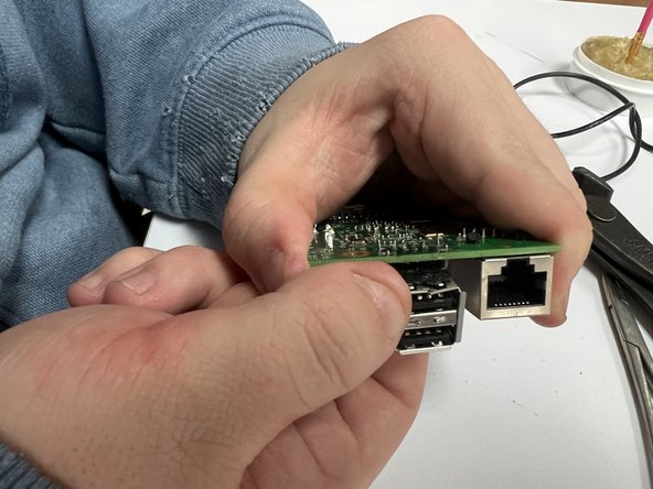

    • After all the solder securing the pins is removed, lightly heat each silver pin. Use a hemostat or needle-nose pliers to disconnect the smaller pins from the board.
    • Remove the faulty port with a gentle pull if necessary.
    • The metal casing of the port might be hot.

    • Insert the replacement port with the open side facing outwards.
    • The replacement part's pins might need a little jostling to be fully seated on the PCB.
