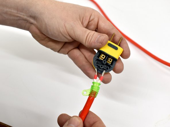

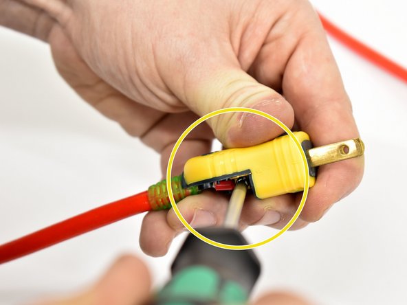

      • Disassemble the plug end
      • To disassemble the power cable plug, you'll need a #1 phillips screwdriver. First, remove the screw securing the blue cover and rubber strain relief.
      • Next, remove the plastic strain relief bracket screw.
    3. Raptor 2 / T REX 3 Cable Chain Update, Disassembly 1b.: crwdns2935265:03crwdnd2935265:01crwdnd2935265:03crwdne2935265:0 Raptor 2 / T REX 3 Cable Chain Update, Disassembly 1b.: crwdns2935265:03crwdnd2935265:02crwdnd2935265:03crwdne2935265:0 Raptor 2 / T REX 3 Cable Chain Update, Disassembly 1b.: crwdns2935265:03crwdnd2935265:03crwdnd2935265:03crwdne2935265:0
      • Loosen the screw terminals to remove both cable ends. They are not polarity specific (side does not matter). The screws just need loosened, not removed.

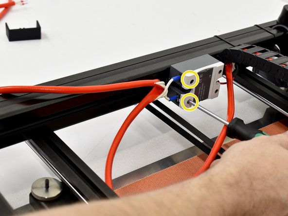

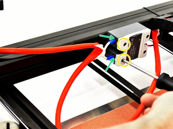

      • Remove A/C power cables from relay.
      • Cut 3 zip ties
      • Remove the printed relay cover
      • Using a #1 phillips screwdriver, loosen the 2 connections 1/2 to 3/4 turn on the AC side of the relay.

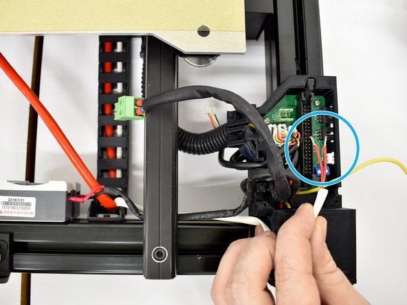

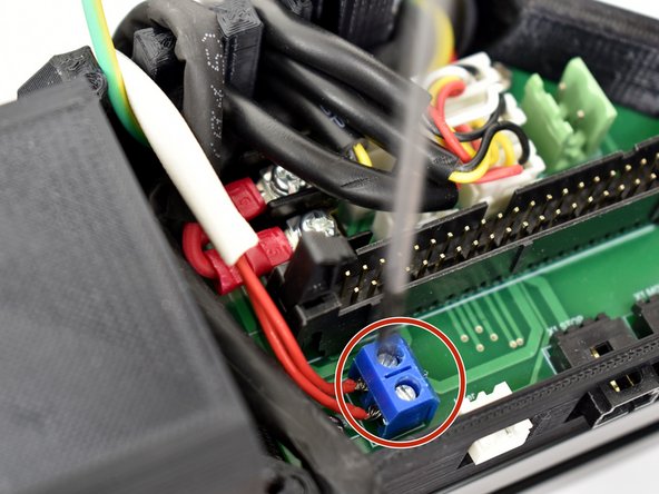

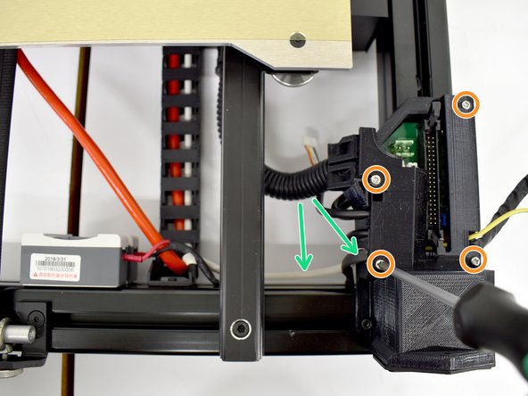

      • Remove the thermistor wires.
      • To access the thermistor wires, you must first remove the daughterboard cover. Using a #1 phillips screwdriver, remove all 4 screws and pull the cover off.
      • Remove the thermistor wires by loosening both sides of the blue phoenix connector with a small flat blade screwdriver then pulling the wires out of the blue connectors.

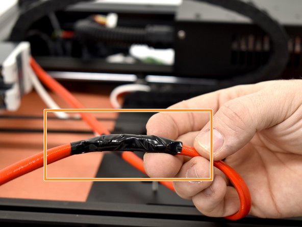

      • To prepare the wiring to fit through the old cable chain, you must tape loose ends with electrical tape.
      • Fold over the relay connections and tape so it is smooth and as small in diameter as possible.
      • Tape the power plug ends together
      • Tape the thermistor wire ends together and to the orange sleeve. (shown in step 8)

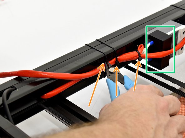

      • To remove the cable chain, you must cut a few more cable ties and remove some screws.
      • Be careful not to cut into any wires or sleeving!
      • Cut any cable ties securing wires to the cable chain.
      • Remove the M3 socket head screw with a M2.5 hex wrench.
      • Loosen the M3 socket head screw to align the T Nut with a M2.5 hex wrench.
      • Remove the M3 socket head screw and T Nut and set aside. They will be installed on the new chain soon.

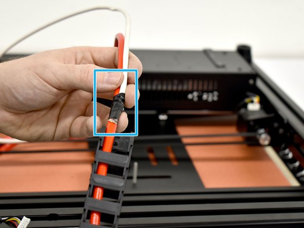

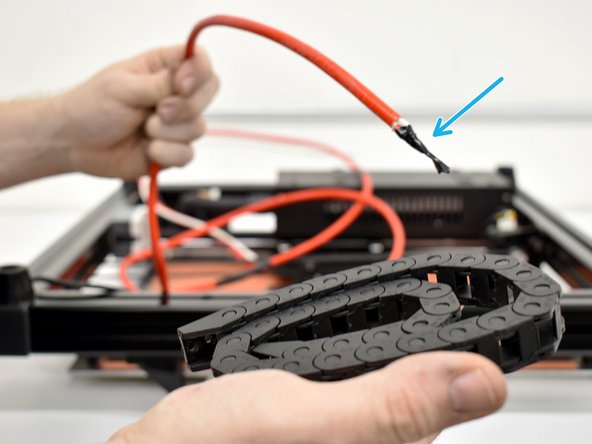

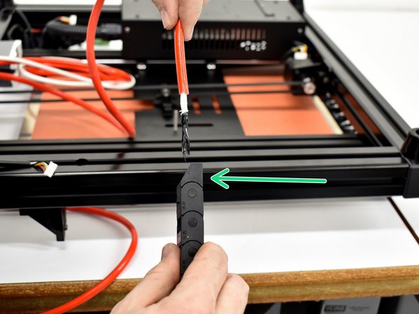

      • Tape the end of the thermistor wires to the orange sleeve. This will make install easier later
      • Pull the old chain off the machine.
      • Hold the wires on the bed side.
      • Start pulling the cable chain away from the bed.
      • With the old chain fully removed, notice the taped end. This will make installing into the new chain much easier.
      • Be gentle! If the cables get stuck, pull the wire back through and inspect your taped areas. They must be smooth and small to fit through the old chain then retry

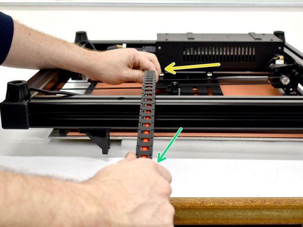

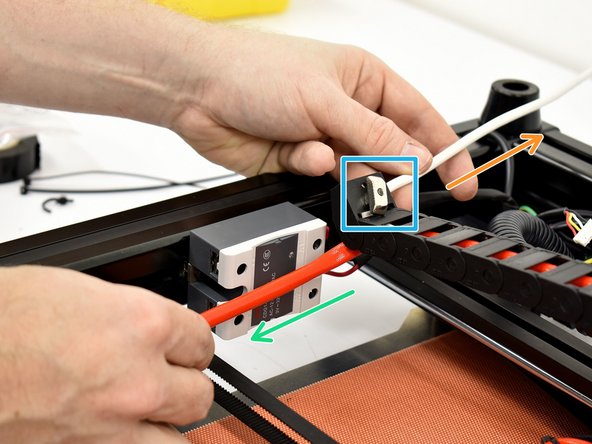

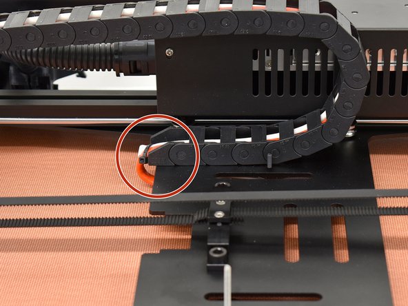

      • The chain has to go on a specific way! You can call it the shorter end or male end but install the side circled in green over the wires going towards the bed heater.
      • Make sure your tape job on all wires that go through the chain is still intact and get your replacement chain in hand.
      • Feed the wires through the new cable chain.
      • Insert the cables into the new chain with the correct chain end facing up.
      • Make sure you have tape here, securing the thermistor wires to the orange sleeve.
    10. Raptor 2 / T REX 3 Cable Chain Update, Reassembly 1b.: crwdns2935265:010crwdnd2935265:01crwdnd2935265:03crwdne2935265:0 Raptor 2 / T REX 3 Cable Chain Update, Reassembly 1b.: crwdns2935265:010crwdnd2935265:02crwdnd2935265:03crwdne2935265:0 Raptor 2 / T REX 3 Cable Chain Update, Reassembly 1b.: crwdns2935265:010crwdnd2935265:03crwdnd2935265:03crwdne2935265:0

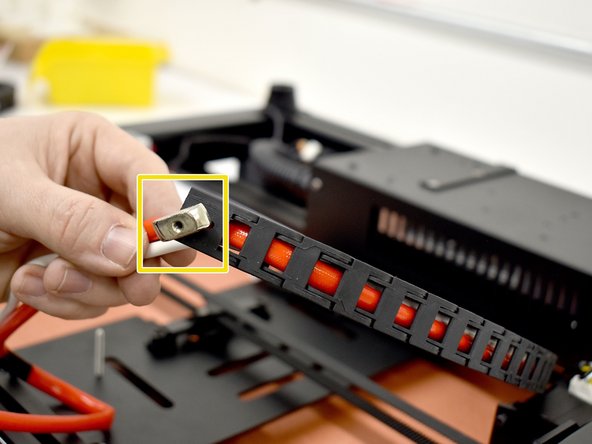

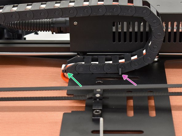

      • Pull the cables all way through the chain until the chain is close to the Y Carriage plate.
      • Leave a little length in the cables so they can be cable tied to the outside hole on the chain end. The M3 socket head screw will go through the inside hole. Tighten it with the M2.5 hex wrench.
      • If the chain does not clear the screw, you may have an earlier version machine and the screw is in a different location. Go to: http://bit.ly/38haROn for help with this.
      • Route the cables to the correct side.
      • The orange sleeve bunch should go towards the relay side.
      • The thermistor wires (some will be red bare wires, some will be in a white sleeve) will go away from the relay.
      • Pre-install the M3 socket head screw and T Nut to the inside hole as the outside hole can be used to secure the wiring.
      • After you have pulled the wires through completely, you can remove the electrical tape.

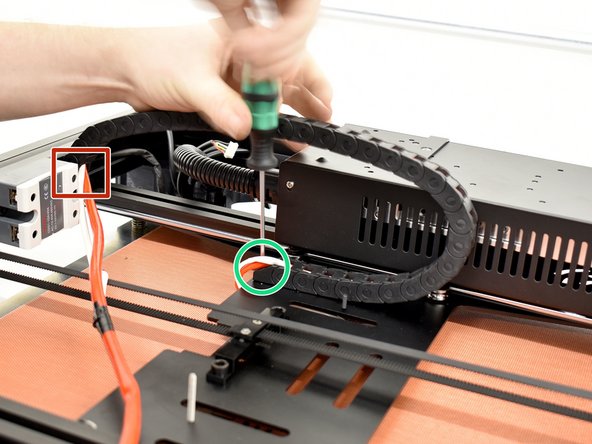

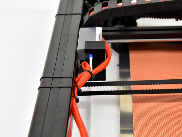

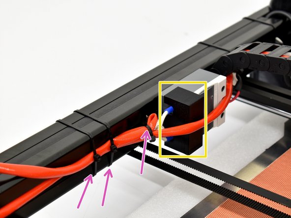

      • Resecure cables to the machine
      • Make sure you secure the cable bundle on each end of the cable chain with a cable tie.
      • Be sure to trim cable tie ends off flush so they are not sharp.
      • Tighten up the frame side chain hold down with a M2.5 hex wrench. This side uses a T Nut and you need to make sure the chain is tight to the frame before proceeding.
      • This screw triggers the end stop. Make sure you position the chain so that it is clear of this screw.
      • Reinstall bed heater connections to the relay. They are not polarity specific (side does not matter).
      • Using a #1 phillips screwdriver, tighten the screw terminals.

      • Reinstall thermistor wires
      • A small pair of needle nose pliers may help with this step.
      • Insert thermistor wires and tighten screw terminals. Be sure to gently pull on them to make sure they are secure.
      • Install printed daughterboard cover with 4 screws.
      • Make sure cables are not pinched and push the cables back into the slot in the frame.
