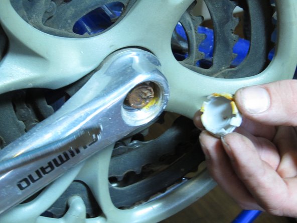

  4. Raleigh M20 Chain Guard Replacement, Chain Guard: crwdns2935265:04crwdnd2935265:01crwdnd2935265:02crwdne2935265:0 Raleigh M20 Chain Guard Replacement, Chain Guard: crwdns2935265:04crwdnd2935265:02crwdnd2935265:02crwdne2935265:0
    • Use a flathead screwdriver to remove the dust cap of the crank arm.
    • Repeat the process on other side.
  5. Raleigh M20 Chain Guard Replacement: crwdns2935265:05crwdnd2935265:01crwdnd2935265:02crwdne2935265:0 Raleigh M20 Chain Guard Replacement: crwdns2935265:05crwdnd2935265:02crwdnd2935265:02crwdne2935265:0
    • Next, use a socket wrench to unscrew the crank arm.
    • Turn the socket wrench clockwise to remove the bolt.
