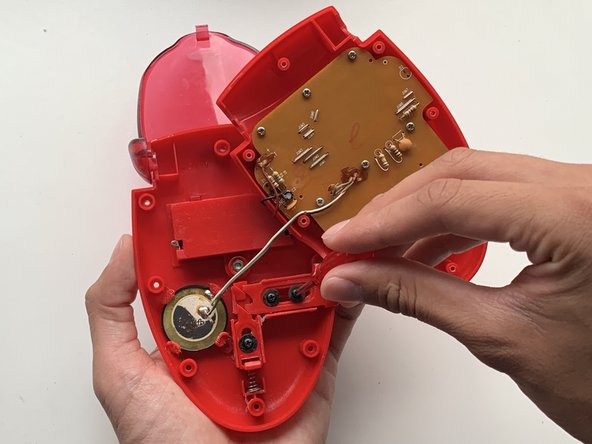

    • Turn over your Lighted Poker so the back is facing upwards.
  2. Radica Lighted Poker Case Lid Spring Replacement: crwdns2935265:02crwdnd2935265:01crwdnd2935265:03crwdne2935265:0 Radica Lighted Poker Case Lid Spring Replacement: crwdns2935265:02crwdnd2935265:02crwdnd2935265:03crwdne2935265:0 Radica Lighted Poker Case Lid Spring Replacement: crwdns2935265:02crwdnd2935265:03crwdnd2935265:03crwdne2935265:0
    • Remove the six silver 6 mm screws with a Phillips #1 screwdriver.
    • Do not unscrew the centerpiece. It is for the batteries.
  3. Radica Lighted Poker Case Lid Spring Replacement: crwdns2935265:03crwdnd2935265:01crwdnd2935265:03crwdne2935265:0 Radica Lighted Poker Case Lid Spring Replacement: crwdns2935265:03crwdnd2935265:02crwdnd2935265:03crwdne2935265:0 Radica Lighted Poker Case Lid Spring Replacement: crwdns2935265:03crwdnd2935265:03crwdnd2935265:03crwdne2935265:0

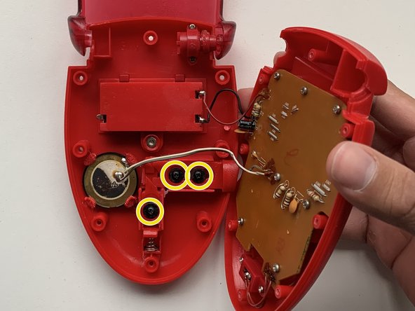

    • Open the device slowly without breaking or tearing the wires.
    • Remove the three black 7 mm self-sealing screws using a Phillips #00 screwdriver.

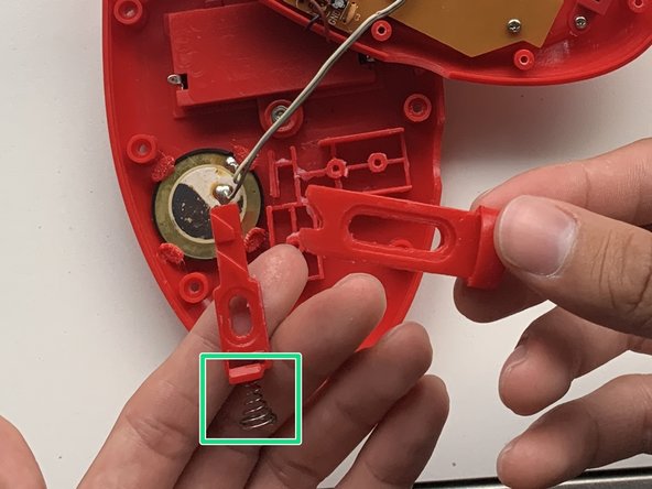

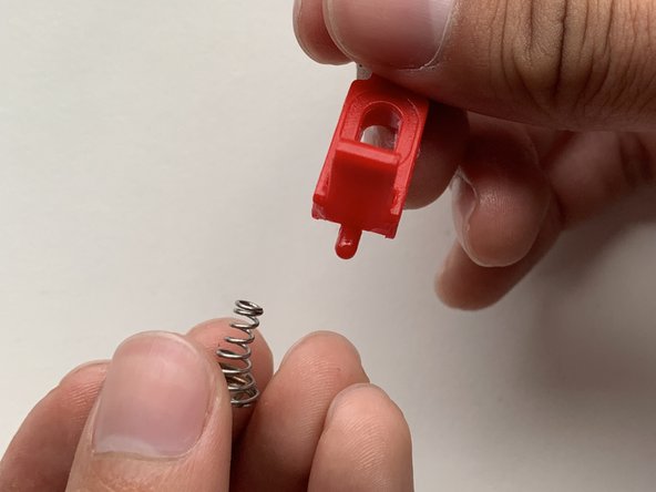

    • Gently remove both the button and hook piece.
    • Remove the damaged or old spring with a new 10 mm long and 8 mm to 3 mm radius spring.
    • Apply a small portion of grease lubricant on the button and hook piece to run smoother.
