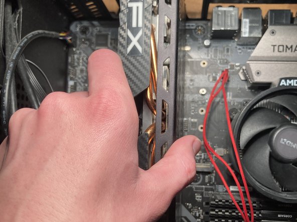

  3. Radeon RX 580 Video Card Fan Replacement, Release from the motherboard: crwdns2935265:03crwdnd2935265:01crwdnd2935265:02crwdne2935265:0 Radeon RX 580 Video Card Fan Replacement, Release from the motherboard: crwdns2935265:03crwdnd2935265:02crwdnd2935265:02crwdne2935265:0
    • Gently and carefully press down on the release mechanism on the PCIE slot of the graphics card.
    • You should hear a click which will indicate proper release from the motherboard (in this case a Tomahawk B450).
    • Do not touch the motherboard with your hands or any other device. It may result in a short.

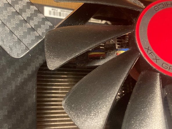

  5. Radeon RX 580 Video Card Fan Replacement, Unscrew both fans: crwdns2935265:05crwdnd2935265:01crwdnd2935265:02crwdne2935265:0 Radeon RX 580 Video Card Fan Replacement, Unscrew both fans: crwdns2935265:05crwdnd2935265:02crwdnd2935265:02crwdne2935265:0
    • Remove the six 1.8 mm screws holding both fans in place by using a Phillips #1 screwdriver in-between the fan blades as the screws are located behind the fans.
    • Do not touch the heat sink with your screwdriver as it may cause substantial damage to the system.

this will not work this way unless you cut and slice wires because the fan connection is under the heatsink. this card needs the be completely opened and thermal compound replaced to replace the fans properly without jerry rigging your fans
J M - crwdns2934203:0crwdne2934203:0
This tutorial is not complete, some extra steps are required to unplug the fans power connector.
Indeed, it’s necessary to remove the plastic support above the heat sink (where fans are screwed on) to be able to unplug the fans power connector.
First, the fan support should be removed and the connector should be unplugged before unscrewing the fans from the plastic support.
