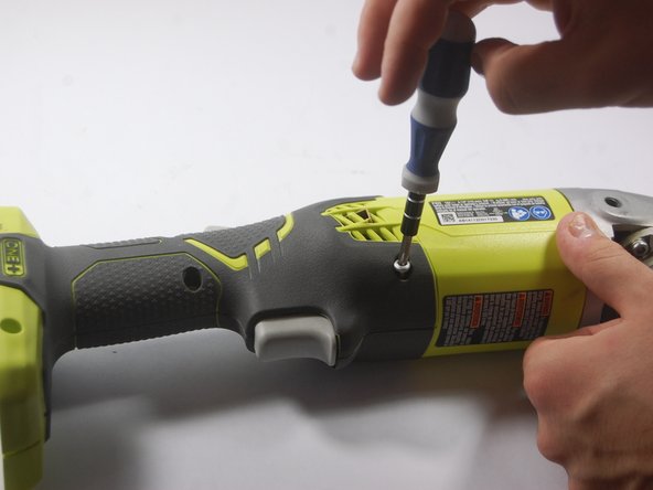

      • Lay grinder flat on its side so the screws are facing up
    2. RYOBI P422 Safety Trigger Spring Replacement: crwdns2935265:03crwdnd2935265:01crwdnd2935265:03crwdne2935265:0 RYOBI P422 Safety Trigger Spring Replacement: crwdns2935265:03crwdnd2935265:02crwdnd2935265:03crwdne2935265:0 RYOBI P422 Safety Trigger Spring Replacement: crwdns2935265:03crwdnd2935265:03crwdnd2935265:03crwdne2935265:0

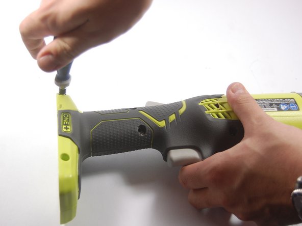

      • Remove the four 1.8 cm screws from the lower and midsection of the body with a T20-20 Torque screwdriver.
      • Remove the 3.7 cm screws from the upper section of the body, with the same screwdriver

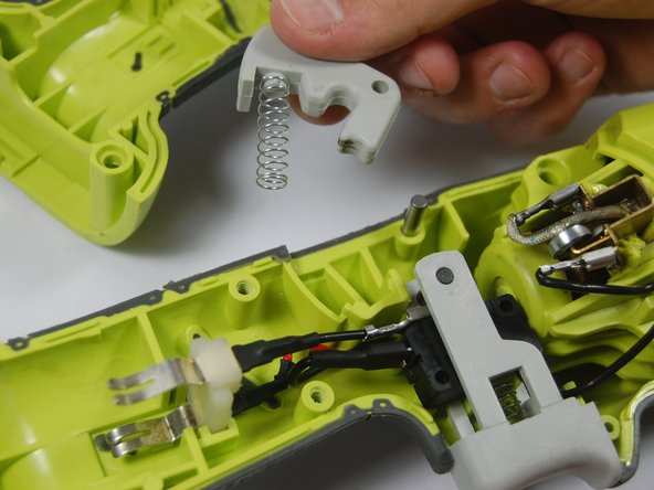

      • Now that the two halves are unscrewed, remove the top half
    4. RYOBI P422 Safety Trigger Spring Replacement: crwdns2935265:05crwdnd2935265:01crwdnd2935265:03crwdne2935265:0 RYOBI P422 Safety Trigger Spring Replacement: crwdns2935265:05crwdnd2935265:02crwdnd2935265:03crwdne2935265:0 RYOBI P422 Safety Trigger Spring Replacement: crwdns2935265:05crwdnd2935265:03crwdnd2935265:03crwdne2935265:0

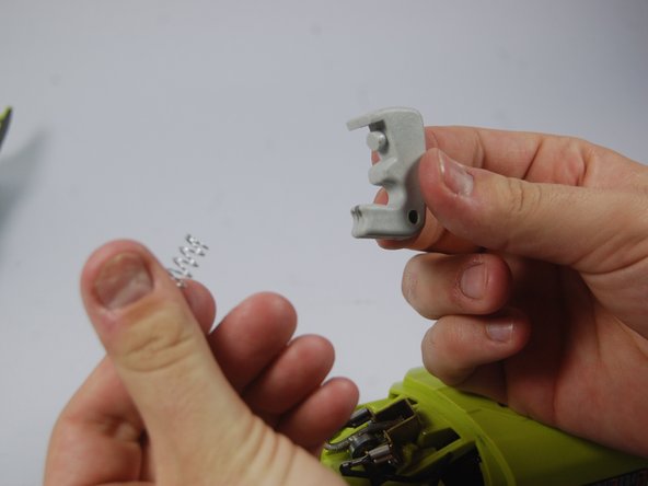

      • Remove the safety trigger along with the spring.
      • To remove the spring, pull it gently off the bottom of the trigger.
      • When putting a new spring in make sure it slides into the grove on the bottom of the trigger.
