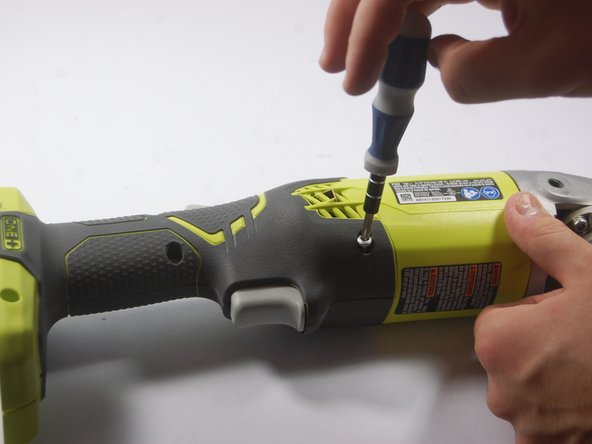

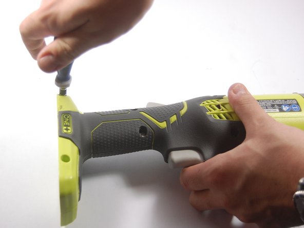

    • Remove the four 1.8 cm screws from the lower and mid section of the body with the Torx T20 screwdriver.
    • Remove the 3.7 cm screws from the upper section of the body, with the same screwdriver.

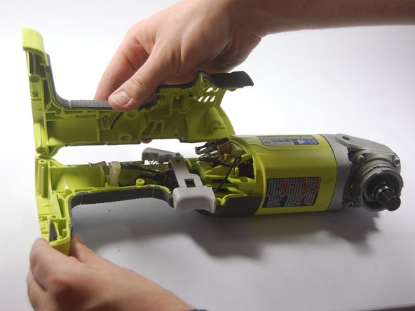

  4. RYOBI P422 Body Replacement: crwdns2935265:04crwdnd2935265:01crwdnd2935265:02crwdne2935265:0 RYOBI P422 Body Replacement: crwdns2935265:04crwdnd2935265:02crwdnd2935265:02crwdne2935265:0

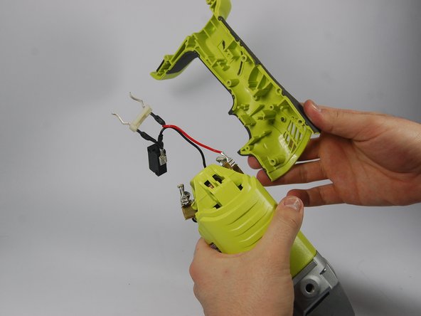

    • Now that the two halves are unscrewed, lift up the top half.

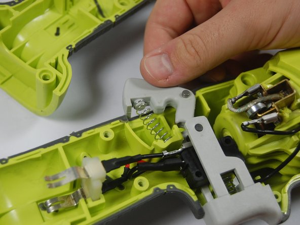

  5. RYOBI P422 Body Replacement: crwdns2935265:05crwdnd2935265:01crwdnd2935265:03crwdne2935265:0 RYOBI P422 Body Replacement: crwdns2935265:05crwdnd2935265:02crwdnd2935265:03crwdne2935265:0 RYOBI P422 Body Replacement: crwdns2935265:05crwdnd2935265:03crwdnd2935265:03crwdne2935265:0

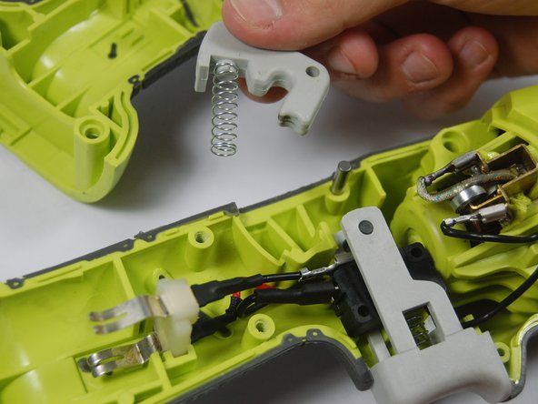

    • Remove the safety trigger and the spring.
    • Be careful in removing the safety trigger, the pin may fall out as you are moving it.
  6. RYOBI P422 Body Replacement: crwdns2935265:06crwdnd2935265:01crwdnd2935265:02crwdne2935265:0 RYOBI P422 Body Replacement: crwdns2935265:06crwdnd2935265:02crwdnd2935265:02crwdne2935265:0

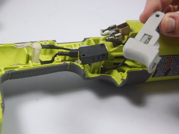

    • Lift up main trigger and spring together.
    • By lifting this trigger and spring out of the handle, you will pull double duty by lifting the black switch box off of its two support posts.
    • Slide the trigger off of the black switch box.
    • Be careful when removing trigger, the spring will be compressed and may move unexpectedly.

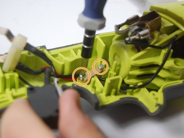

  7. RYOBI P422 Body Replacement: crwdns2935265:07crwdnd2935265:01crwdnd2935265:03crwdne2935265:0 RYOBI P422 Body Replacement: crwdns2935265:07crwdnd2935265:02crwdnd2935265:03crwdne2935265:0 RYOBI P422 Body Replacement: crwdns2935265:07crwdnd2935265:03crwdnd2935265:03crwdne2935265:0

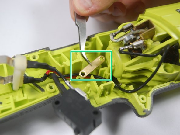

    • Lift the battery lead bracket from its slot.
    • Use the PH 1 screwdriver to unscrew the two 0.7 cm screws that hold the 2.6 cm long brass bracket in place.
    • Use tweezers to remove the brass bracket.
    • During reassembly, remember to keep the spring inside the main trigger and against the bracket that is visible in the second of the accompanying photos.
  8. RYOBI P422 Body Replacement: crwdns2935265:08crwdnd2935265:01crwdnd2935265:02crwdne2935265:0 RYOBI P422 Body Replacement: crwdns2935265:08crwdnd2935265:02crwdnd2935265:02crwdne2935265:0
    • Flip the grinder over and lift off the second half of the body.
    • Now you can replace your damaged handles with a new pair.
