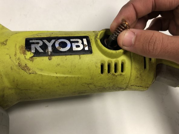

  6. RYOBI AG454 Motor Replacement, Carbon Brush: crwdns2935265:06crwdnd2935265:01crwdnd2935265:01crwdne2935265:0
    • Remove the brush caps from each side of the body using the 4 mm flat head screwdriver.
  7. RYOBI AG454 Motor Replacement: crwdns2935265:07crwdnd2935265:01crwdnd2935265:01crwdne2935265:0
    • Remove the carbon brushes.
  8. RYOBI AG454 Motor Replacement, Driveshaft: crwdns2935265:08crwdnd2935265:01crwdnd2935265:02crwdne2935265:0 RYOBI AG454 Motor Replacement, Driveshaft: crwdns2935265:08crwdnd2935265:02crwdnd2935265:02crwdne2935265:0
    • Remove the two carbon brushes from both sides of the device.

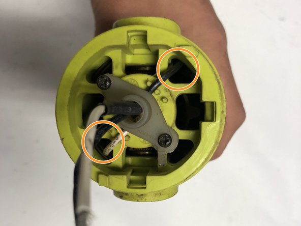

  19. RYOBI AG454 Motor Replacement: crwdns2935265:019crwdnd2935265:01crwdnd2935265:02crwdne2935265:0 RYOBI AG454 Motor Replacement: crwdns2935265:019crwdnd2935265:02crwdnd2935265:02crwdne2935265:0
    • Using a Phillips #1 screwdriver, remove the two screws from the bracket on the bottom of the body.
    • Remove the bracket from the device.
    • When reassembling be sure to pull the wires back through these two holes.
